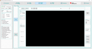

I just purchased the DLPLCR90EVM with the DLPLCRC900DEVM. We connected the cables, powered on the DLPLCRC900DEVM. The box labeled "controller/DMD incompatible" is checked. We tried switching to "normal" mode, but after a second, it automatically switches back to "Standby" mode
We cannot switch to pattern on the fly mode

    On the left section of the GUI, I see that this is programmed with a firmware tag, "dlp670s_..."
    This firmware is expecting to see a DLPLCR67EVM rather than the DLPLCR90EVM, causing the controller to go to standby mode. Please have the customer follow these steps I have copied from another recent thread.

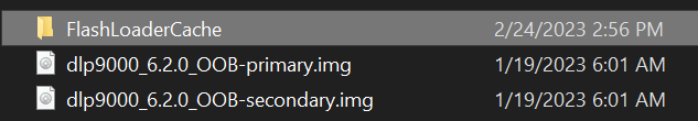

    When uploading the firmware to the DLPLCRC900DEVM, they must select both the primary and secondary firmware files at the same time. There is one *.img file per ASIC on board, with the DLPLCRC900DEVM having two total. More information may be found in the Section 3.9 of the user's guide on how to program the board.

      4. Go to firmware page click 'Browse..."and locate the firmware (*.img) file for the DLP9000. This is typically located under "C:\Texas Instruments-DLP\\DLPR900PROM-x.x.x" for Microsoft Windows machines, where "x.x.x" is just the firmware version.
      5. Delete the FlashLoaderCache directory if it exists. This is created every time you upload a firmware. The GUI caches it so new firmware loads flash quicker, but when building completely new firmware, this may cause errors. Delete this if building or flashing brand new firmware.
      6. Open the *OOB.img firmware files for your DMD. You must select both. Click "Upload" and wait until flashing and verification complete.
