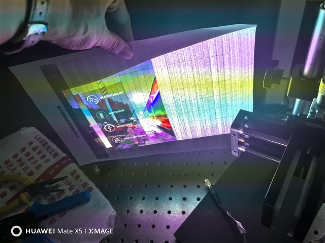

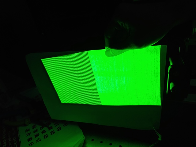

The DLP4710EVM-LC have problem that it only displays half of the image in every mode. The issue occurs in "light control" mode , "display" mode .
At first , the EVM can normally display patterns , but it cannot output "triiger2" signal in light control mode and it can output "trigger1" signal (I have connected pin2 and pin3 of J7 , pin2 and pin3 of J9). So ,I update the firmware and the EVM cannot display pattern normally. I have updated firmware in version "v8.1.0","v8.3.0" and "v8.4.0" , but the issue still occurs and the EVM also cannot output trigger signal.

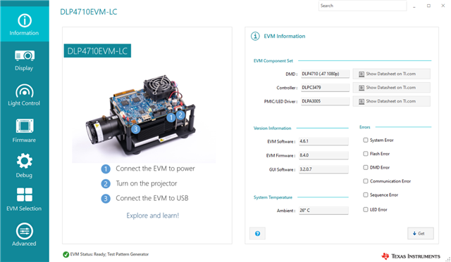

  • Hello Aaron,
    We bought the EVM about 6 months . We bought the EVM in 24th April . However , we didn't used the EVM from july to 4th November , and the issue occurs in 4th November.
    I have updated firmware of 3 different versions , and the informations of 3 versions are showwed above . The issue still occurs in these firmwares. I notice that the D33(M_IRQ) and the D34(S_IRQ) both light up when I turn on the EVM .

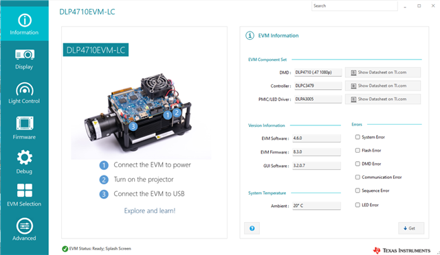

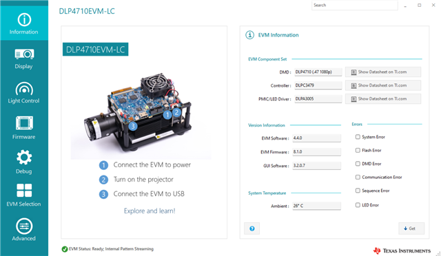

  • Hello Aaron,
    I uninstall the GUI 3.2.0.6 and install the GUI 3.2.0.7 . Also , I updated the firmware including v8.1.0 , v8.3.0 and v8.4.0. Here is the screenshot of the information page of GUI.
    The issue still occurs. I also test the output trigger .The output trigger1 signal is normal , but the output trigger2 signal can not be detected.
    Zhiyuan Liu

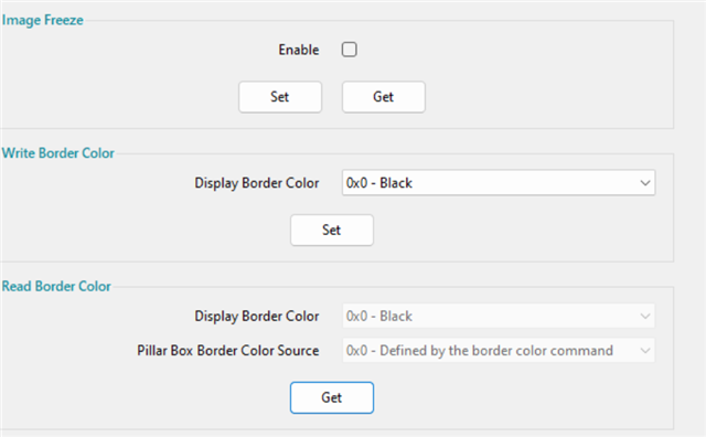

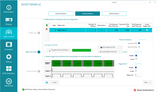

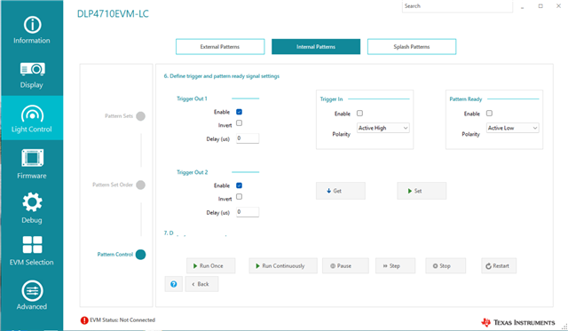

    Please share a screen-grab of the Internal Pattern or External Pattern screen you have defined when you are trying to display your image, the Trigger Out 2 setting should be 'Enabled' if you want to view this.

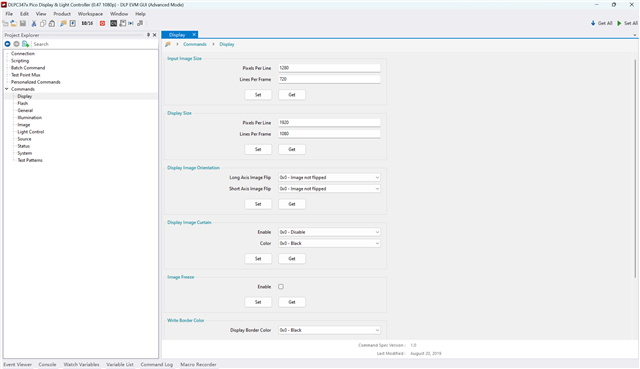

    Could you also go to the advanced mode and perform a 'Get' for the 'Display' tab input 'Input Image Size', 'Image Crop', and 'Display Size' fields?
    Aaron

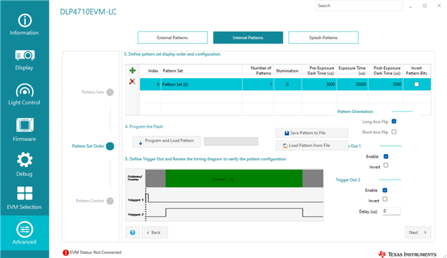

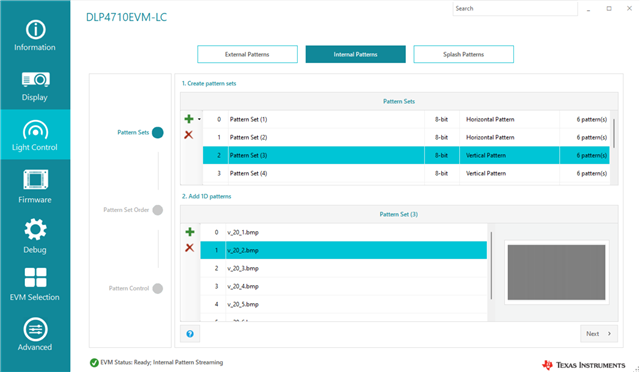

  • Hello Aaron,
    The firmware version is v8.4.0 and GUI version is v3.2.0.7 . The screenshot of "internal pattern" in light control mode are showwed as below. As you see , I set "enable" of trigger1 signal and triiger signal , and trigger1 signal can be detected while trigger2 signal cannot be detected. The trigger1 signal and trigger2 signal both be set "enable" in last few days' detection , and the issues always occur.
    The screenshots of advanced mode are showwed as below. I didn't change any settings in advanced mode. The issues seem like one of controller lose control of half DMD and it fail to output trigger2 signal. I wonder if the EVM has some hardware damage? If the EVM has some hardware damage , where can I find maintenance service?

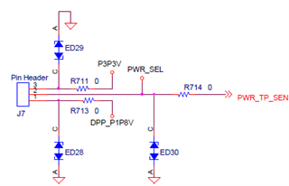

  • Hello Zhiyuan,
    I agree that there is something wrong here. I need to refer back to the original question here where you stated:

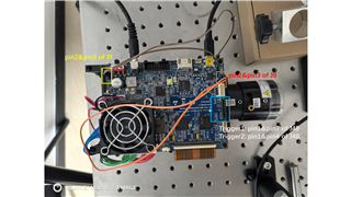

    Are these the connectors you are referring to?
    Could you please advise further on how you are connecting these? Are you connecting Pin2 to Pin2 / Pin3 to Pin3? Or are you shorting Pin2-Pin3 on both or something different?
    Lastly, where are you testing Trigger 1 and Trigger 2 as well as Trigger In?
    Aaron

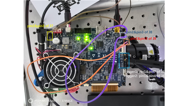

  • Hello Aaron,

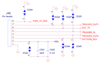

    These connectors are I referring to. I have connected pin2-pin3 directly both. I use a oscillograph detecting pin1 and pin4 of J48 to get trigger2 signal and detecting pin1 and pin7 of J48 to get trigger1 signal. As you see , I get the information from the user guide of DLP4710EVM-LC
    best,
    Zhiyuan Liu

  • Hello Aaron,
    I have connected pin2 and pin3 of J8 , but the issue still occurs.
    best ,
    Zhiyuan Liu

    I'd like to make sure you have J48 connection correct, you have labeled pin 7 and pin 4 being tested for Trigger 1/2 and you have connected pin 1 and 4:
    This would be GND (pin1) and Trigger_Out2:

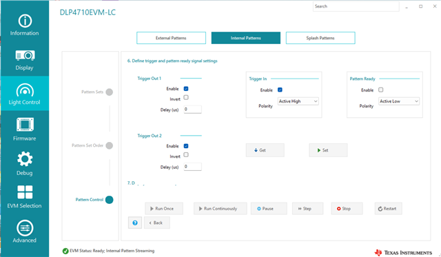

    previously you also shared that you have no trigger_in enabled in your internal pattern project please enable this if you are intending this:

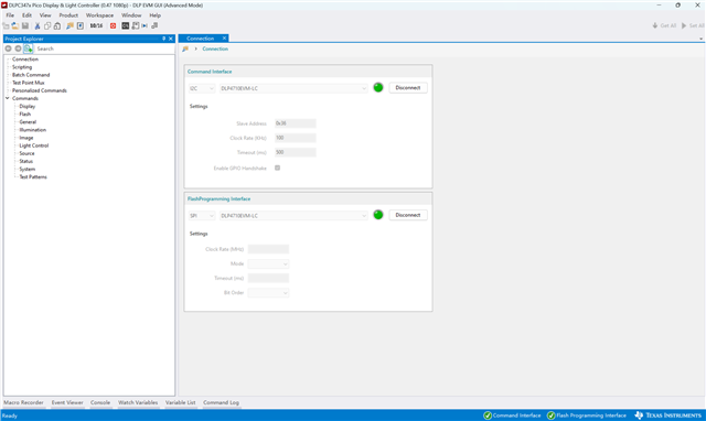

    Lastly, to test which controller is having an issue, we can use the advanced mode -> Projector Control -> Debug -> Write ASIC Select and utilize ONLY the Master or Slave controller and see which controller is not responding to a display update or change through TPGs.

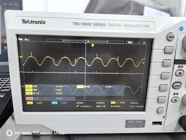

  • Hello Aaron,
    1,

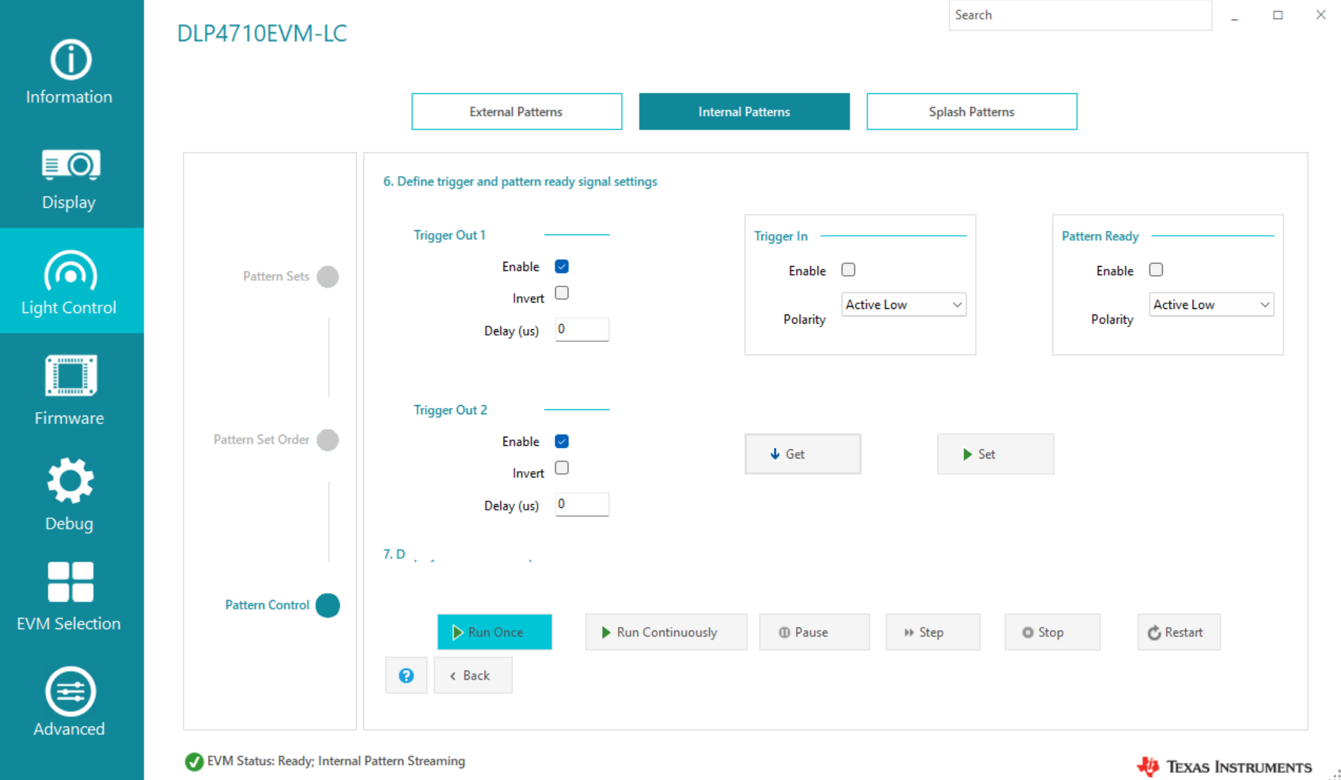

    I set "trigger in" to "Enable". We don't have a 3.3V square wave generator , so , I use a 3.3V DC power supply connect its negtive electrode and pin1 of J48. When I use its positive electrode touch the pin5 of J48, the projector's "light control" function can be activated but the issue still occurs. Here is the settings .
    2,
    I do have tested "trigger out 1" signal using a oscillograph and connect pin1 and pin7 of J48 . Also , I do have tested "trigger out 2" signal using a oscillograph and connect pin1 and pin4 of J48 . Here is the light control settings.

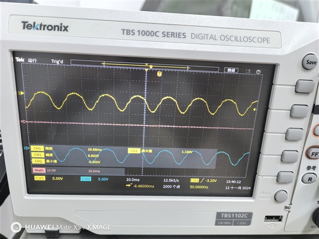

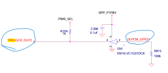

    Here is the photos of the oscillograph. As you see, in photo1 , the yellow line means the voltage of pin7 while the blue line means the voltage of pin1 . And the red line means the voltage of pin7 - pin1 . So, the trigger1 signal is  normal . However , in photo2 , the  the yellow line means the voltage of pin4 while the blue line means the voltage of pin1 . And the red line means the voltage of pin4 - pin1 . The trigger2 siganl cannot be detected.
    3,
    I can't find a mode named " Projector Control" in advanced mode.

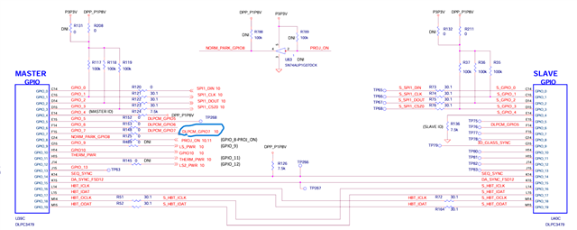

    I wonder if there's something wrong with the master controller? According to the DLP4710EVM-LC schematic file, the trigger2 signal comes from the master controller.
    4,
    We purchased the EVM on Mouser on April 24, 2024. Where can I find repair service if the EVM has some hardware damage? Can you recommend some repair services in China?
    best
    Liu Zhiyuan
