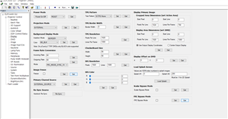

  • Hello Aaron,
    Good day.
    I attached my 'display' setting in this mail.
    Here's my new question.
    1. What can I do for solving display distortion?

    Thanks for sharing your display page, it does seem like your image is being cropped as expected when keystone is performed.
    1. There are multiple reasons why distortion might be occurring, but the keystone tab tab should be able to correct your 2D keystoning as long as the vertical or horizontal tilt is beyond 30 degrees.
