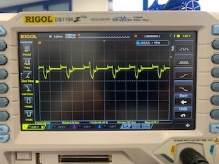

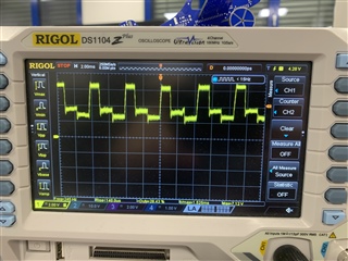

We have implemented a system using the DLP3430 and DLPA2000. However, we’re encountering an issue when setting the display brightness to maximum. When this happens, the display freezes and turns black and white. We performed some measurements, and the waveform on the VLED pin is as shown in the attached image. Additionally, when this occurs, the V6V signal drops to 0 volts for a brief period.
Could someone provide assistanc e with this issue? Thank you in advance!

    I just want to double check that this is a custom system you have designed and not the DLPDLCR2010EVM? If it is a custom design were you basing it off of this reference design? (https://www.ti.com/tool/TIDA-00325)

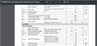

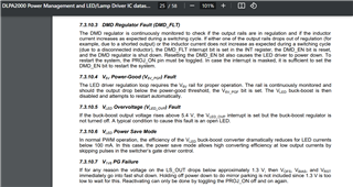

    The voltage measurements you have taken seem to be outside of the normal operating conditions of the DLPA2000 for VLED. The below specifications are from the DLPA2000 datasheet. Additionally what LEDs are you using with your design?
    I see from the DLPA2000 datasheet here that there are these fault conditions descriptions that perhaps may be what is occuring.
    What do the waveforms look like at a lower brightness for VLED?

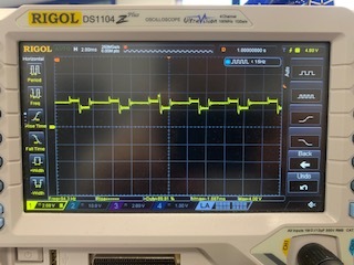

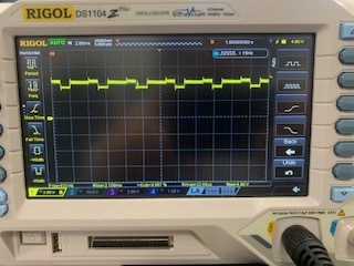

    I’ve checked the datasheet, and based on the measurements I sent for VLED, I agree that the voltage was too high. I managed to stabilize it by increasing the capacitance on VINL of the DLPA2000. Previously, it was 150µF, and now it’s 440µF (2x220µF). On the VLED pin, we currently have a 47µF capacitor (which we haven’t changed).
    With this adjustment, the voltage level has stabilized so far, as shown in the attached pictures. However, the problem persists when I try to exceed 90% of the display brightness.
    Do you think increasing the 47µF capacitor on VLED would help in this case?
    VLed at minimun brightnees.
    VLed at 50% of the brightnees.
    VLed at 90% of the brightnees.

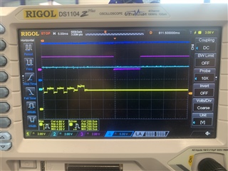

    I don't immediately see anything wrong with your Vled waveform. Could you please check the status of each of these power lines before and after the fault occurs?
    Additionally can you please confirm the firmware you are using?
    Max
  • Hello Maximus,

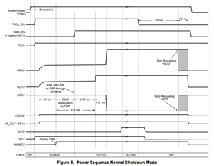

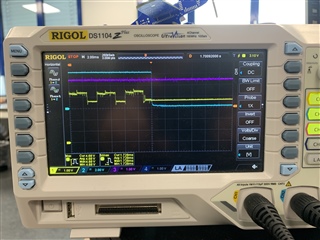

    I have reviewed the power lines from Figure 5 and observed that the V6V line drops when the Buck-Boost regulator stops working. As shown in the following pictures, the rest of the signals do not appear to be affected.
    Channel 1: VLED
    Channel 2: V6V
    Channel 3: LS_OUT
    Same Pic (Zoom in)

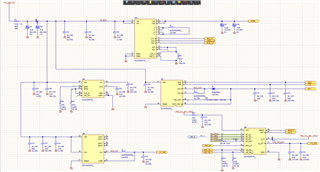

    Thank you for this information, could you please send me your PMIC schematic? I am discussing this issue internally with our hardware team to see if they have seen this issue before.
    Max
    This is the schematics or the PMIC, also this the firmware version I got:

    C106 and C107 are not populated.

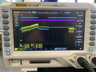

  • Hello Alvaro,
    More specifically could you check the system power input for glitches or sags as well as check if RESETZ or INTZ go low?
    Max
    Between 3.7V and 4.2V.
    Ch1: VLED
    Ch2: Vin
    Ch3 RESETZ
    Ch4: INTZ
