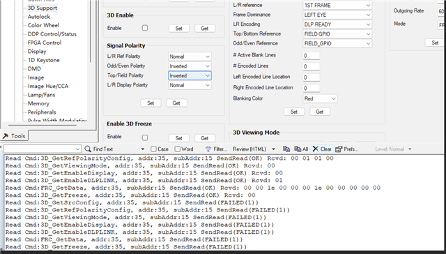

  • When I power on the DLPC4420EVM, the USB device appears for a few seconds and allows me to communicate with the DMD via the DLPC44xx GUI.
  • However, after a few seconds, the screen goes black, the USB device disappears from Windows Device Manager, and I lose all control over the DMD.
  • During the short period when USB is active, I am able to load test patterns and make adjustments, but as soon as the USB disconnects, the DMD stops displaying any content.

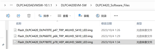

  • I have already reflashed the firmware multiple times using Flash_DLPC4420_DLP780TE_xxx.img, but the issue remains the same.

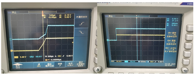

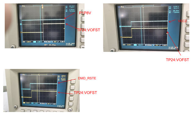

    Can you please measure the DMD power up sequence and the DLPA300 power up/down sequence and share the captures in the thread here? Please refer to the measurements on the attached E2E.
    Lori
  • Thank you for your response.
    Below are the results:
    VDD1 :remain at 1.8V,BOTH SW1 ON and OFF。
    VCC2:At 0V before SW1 OFF,remain at 10V after SW1 ON.
    VOFST:at 0V before SW1 is turned on,remain at 11.3V after both SW1 is turned on and the logo disappears.
    VBIAS:at 0V before SW1 is turned on,remain at 20V both SW1 is turned on and the logo disappears.
    SCPEN and IRQ remain at 3.3V both before and after SW1 is turned on.
    RESET is at 0V before SW1 is turned on, then stays at 3.3V until the logo disappears.
    Do you mean when the logo disappear, VOFFSET and VBIAS are remaining at 11.3V and 20V accordingly?
    Can you please share the waveform capture? I also would like to see the power up sequence/timing.
    Lori
  • Yes,when the logo disappear,VOFFSET and VBIAS are remaining   at  11.3V and 20V.the waveform as follows picture 2。( the power up sequence as Figure 1

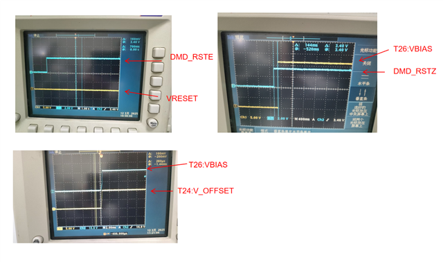

    Can you please provide the power sequence as section 8.2.3 on the DLPA300 datasheet?
    For example, capture 1 (CH1: VOFST; CH2: VBIAS; CH3: DMD_RSTZ; CH4: VRESET). Capture 2 (CH1: VOFST; CH2: P1P8V; CH3:DMD_RSTZ; CH4: VCC2).
    Meanwhile, can you please confirm you have followed the quick start procedure in the DLPC4420AEVM user's guide? Do you see any change if you re-program the EVM?
    Lori
  • I only have two channel probes now.Figures 1 and 2 show the High Voltage Power-Up Sequence.And i don‘t  see any change after re-program the EVM.
    Based on your captures, I have a few questions:
    1.You've never seen VRESET boot up, right? This doesn't make sense if you see the image on the DMD after power up.
    2. The captures that you shared above are the whole process when you see the image on the DMD, then the the image disappear and you cannot communicate with GUI?
    I suspect that you should see a voltage drop when the image disappear.
    3. It seems like the same behavior can be repeatable, right? That means, every time you power cycle the EVM, you can see the image on the DMD, and after a few seconds, the image disappear and you can't communicate with GUI.
    Lori
  • Hello
     1.Yes, I never seen VRESET boot up.
     2. After powe on, the USB is connected and a logo appears. After the logo disappears, the USB is not connected.
     3.Every time i power on cycle the EVM, this behavior can be repeatable.
     4.The captures that I shared above are the whole process when you see the image on the DMD, then the the image disappear and you cannot communicate with GUI.And i don't see a voltage drop when the image disappear.(Just appeared voltage drop untill SW1 is turned off)
    What problem of this board?How to solve it ?

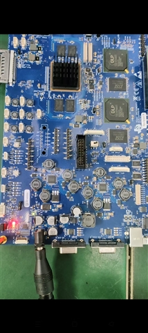

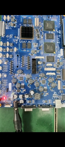

    meanwhile,when SW1 pull on, At the beginning, the red light D6 was on,And The light D5 keeps flashing .After DMD logo disappear ,Both  D5 and D6 are turn off.

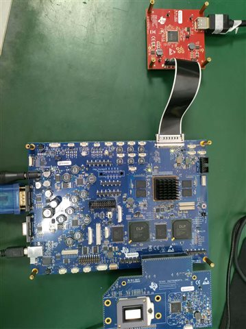

  • Hello user,
    Can you please help to check one more thing on your set up?
    Do you have the front-end board connected, I cannot see it in the picture? Has there been any modification?

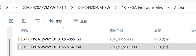

    When you power up the system, please make sure the FPGA is coming on that you can see D10 is ON.
    If the D10 is not ON, then please reprogram the FPGA. The FPGA firmware and programming guide are in the package of the software release.
    Lori
  • 1.this board that i don't set up any thing. Normally,When i purchased this board ,it should work  properly witout set up anything.
    2.yes .i have the front-end board,And FPGA is coming,the D10 IS NOT ON,After programming FPGA firmware ,the problem  the same as before.
    3. Resently,I use the new firmware ,it use connect afer logo disappear,And i can set some parameters but not all from DLPC44XX GUI,but FPGA Fail the same as before.
    4.do you have the newest firmware of FPGA for this board .78.can you send it to me ?

  • HELLO
    1.The performance of this circuit board in recent days without Parameter Configuration,When the FPGA is coming on that I can see D10 is ON(The D10 didn't turn on originally)
    2.When i use  HDMI cable Connect to the computer,The HDMI connection to the computer fails to establish link status。What 's the problem of this trouble.
    3.The status of The indicator light not changed on Front-end Board.
    4.After EDID reprogramming failed to resolve the HDMI link establishment issue。
    5.Crystal oscillator has no signal output on the Front-end Board(ITE6807).
    Attached are the UART console outputs

  • you company send me the Latest  version of software(Flash_DLPC4420_DLP780TE),I download it.the board  can connection via stable USB.
    But have HDMI link establishment issue,And i didn't see dispaly imag on DMD with HDMI connection.
    I reprogramed EDID via EDID_Programmer_Tool.(But it  have same HDMI link establishment issue),the crystal oscillator have any clock signal on the board of ITE6807.
    Did you download the Flash_DLPC4420_DLP780TE image file from TI.com or someone from TI provided you this image file?
    Lori
  • Yes,I the download Flash_DLPC4420_DLP780TE image file from TI.com ,But the above problem appeared,usb disconnect after DMD logo disappear.
    Ater Your colleague provided you newst image file,the board  can connection via stable USB.
    But have HDMI link establishment issue,And i didn't see dispaly imag on DMD with HDMI connection.what's the problem of this.
    Does this board need after-sales service? this board had this issue when we first bought it.

    Can you notice there is any modification on your front end board ITE6807 board? If not, you need to change the I2C communications from I2C_1 to I2C_0 for DLPC4420 to use the HDMI connection.
    Please see the steps to make modifications:
    1. remove R17 and R18
    2. Add blue wire from R17 to TP5
    3. Add blue wire from R18 to TP7
    4. We will provide you an updated EDID file for DLPC4420.
    Lori
  • Thanks,Lori
    She said you are colleagues.Susan.
    There‘s not  any modification on the front end board ITE6807 board.
    I have removed  R17 and R18.And Add blue wire connect to each other.
