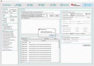

I'm trying to update firmware of my DLPLCR900DEVM, once I clicked the 'Upload' button, the GUI shows an Error message saying "Unable to read flash device IDs. Error: Invalid command number : 0x15" and D9 stopped flashing but D7 is still flashing. I have updated firmware to this board's default firmware from v6.0 to v6.3 two weeks ago, and it was working fine.

  • Hi Aishwarya
    I just understood what do you mean by "Are you able to program with the boothold jumper installed?", and I just tried again with the following steps, it worked with both FW v6.2.0 / 6.3.0 and GUI v5.2.0 / 5.3.0 :
    1, Start with power off, removed RESET jumper, install the BOOTHOLD jumper.
    2, Connect the USB cable and power on the board.
    3, Open GUI, manually select the Chipset Type (mine is DLP670S), select firmware and click 'Upload' button.
    Could you please advise why the the GUI shows the error when BOOTHOLD jumper isn't on?

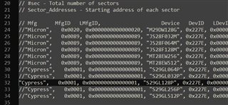

    1, At very early time I have modified "FlashDeviceParameters.txt" in "DLPC900REF-SW-5.3.0\DLPC900REF-JTAG" folder to match the flash on my own PCBs, screenshot below shows how I changed it, as my is S29GL128P90FFIR20.
    It was fine at this point, as I can repeatedly reload firmware v6.0.0 for my onw boards, but I have not tried with your DLPLCR900DEVM yet.
    2, About two weeks, I have installed firmware v6.3.0 and uploaded this version to the three PCBs, everything went well from 6.0.0 to 6.3.0
    3, At a time, I have modified "FlashDeviceParameters.txt" in "DLPC900REF-SW-5.3.0\DLPC900REF-SW-5.3.0\DLPC900REF-GUI\Flash" folder to match the screenshot above. I cannot remember this happened before installing v6.3.0 or after.
