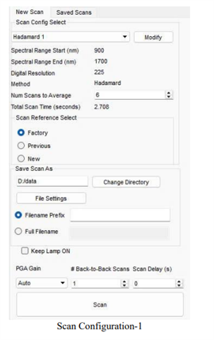

Here are the steps I took and the results I got. I reconnected the J2 connector in the TIVA board and the J1 connector of the Detector board. After reconnecting the connectors, the result didnot change. I also tried buying a new micro USB cable but still no change(short and with noise protection)

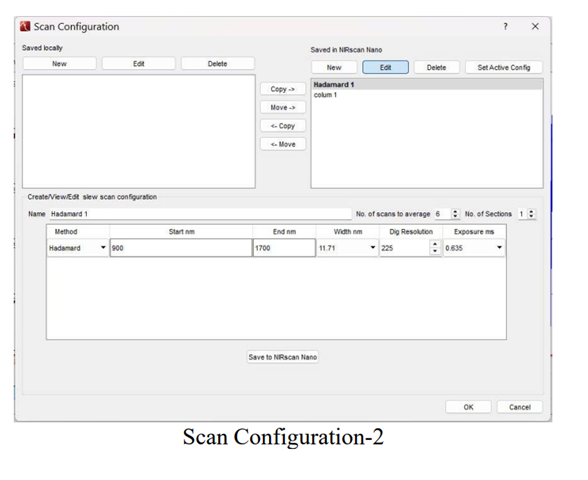

Here are all the methods and results I tried:

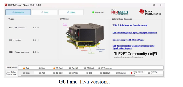

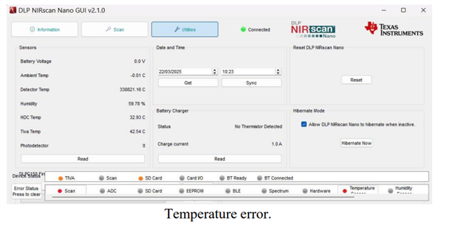

- Accompanied by 2 errors "TMP006 Error: Write Register Error" sometimes "TMP006 Error: I2C Error" and "Scan Error: ADCDataerror".
- The green and yellow indicator lights flash once per second .

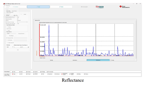

- Because I doubt the cable, I tried scanning with the button on the board to save directly to the memory card and then rechecked thefilescanning process but it was still noisy. (The power applied 5V1A)
- Reset on the GUI and on the board but still the same
