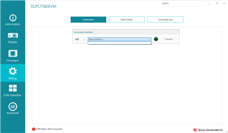

  • I downloaded the DLPDLC-GUI from the DLPC7540EVM page.  it is version 3.2.0.7.  I selected the DLPC7540EVM and no board shows up when it is connected to usb.  It says "EVM Status: Not Connected"  This has always been the case since I received the board.  The board never shows up on the debug tab of the GUI to be able to connect.  The bootloader did program and finish successfully, but there is no change in the behavior in the GUI.
    Aaron
  • Hello Aaron,
    Can you please share the screenshot of the debug tab of the GUI to make sure you have USB interface is selected?
    Can you please probe pin 1 of the micro-USB connector (J2)? This might be indicative of lost of communication through USB based on voltage level.
    Can you also make sure if you can have the debug log by using a RS232-to-USB cable connect with J102? The debug log is sent through serial port using a baud of 115200. I would recommend using the TeraTerm application but many are available.

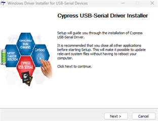

    It seems that a driver is missing. The GUI needs a driver to be connected.
    Please double check device manager to see if the USB is recognized. You may want to try to uninstall and reinstall the GUI.

    Thank you for confirming! Do you also install or checked the cypress driver download box when installing the GUI?
    If yes, then I need to investigate more to see if we have other solution for you.
    Lori
  • Yes The drivers were installed.  I'm sure the unit was just DOA, I just need confirmation so Digikey will RMA it
