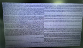

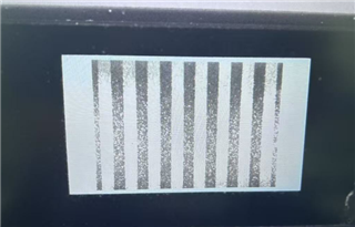

  • Static micromirror pattern persists on the DMD glass surface, resembling the projected working image (line patterns).
  • Partial functionality retained:
    • Driver board successfully identifies the DMD (valid ID readback).
    • Control commands (e.g., pattern switching) are transmitted, but micromirrors fail to flip mechanically.
  • Driver board validated: Functions normally with other DMDs, confirming board integrity.

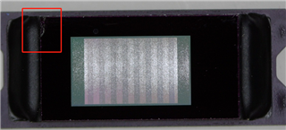

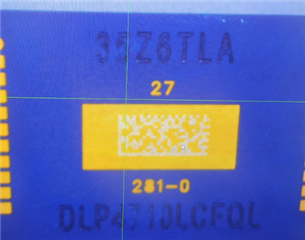

  • Figure 1: DLP3010 DMD failure pattern.

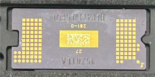

  • Figure 2: DLP4710LC DMD failure pattern + batch info.

  • Dear Aaron ,
    To confirm, the affected models are:
    • DLP3010 (legacy version)
    • DLP4710LC (batch information shown in the previous images)
    Regarding the two abnormal optical engines:
    1. The stuck patterns observed are not the only patterns in the system's cycling sequence. Both firmware versions store 18 patterns per set, with differences only in their configured dark/exposure times.
    2. Each defines a single pattern set (18 patterns total). The stuck pattern likely corresponds to one of these cycling patterns, as its orientation (horizontal/vertical) matches one of the projected patterns.

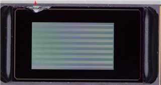

    Furthermore, after disassembling and analyzing the defective optical modules, we discovered additional issues:
    1. Both the 3010 and 4710 DMDs have glass damage, with the 4710 being more severe. Please refer to the images below:
    After verification:
    • For the 3010 DMD: Functional testing after assembly showed no issues before shipment. We cannot determine whether the glass damage existed before assembly or occurred during extended use - though we believe the former is more likely.
    • For the 4710 DMD: Functional testing after assembly showed no issues before shipment.
      We can confirm the DMD glass was defective before assembly. This is because the DMD was previously installed in an incompatible structure, and the glass was damaged when screws were tightened against it.. Since this unit was sent to the customer for debugging purposes, we evaluated that the surface damage would have minimal impact and approved it for special shipment.
    As we are not familiar with the DMD's internal circuitry, materials, manufacturing processes, or operational principles, we request your engineers to confirm:
    • What risks exist when the DMD glass is damaged?

    Could you confirm for me that the stripes you are seeing on the DMD are seen while the DMD is off?
    Aaron
  • Hello Aaron ,
    Confirmed: The stripes remain visible on the DMD when it is powered off.
  • Hello Junfa,
    Thank you for the confirmation! These kinds of lines are common when powerdown procedure is not followed. These usually wouldn't effect performance when powered on.
    Returning to the stuck pixels, my teams thoughts are still on the glass damage and compromising the bond of the glass. It is important that this not be exposed as ambient air greatly decreases the lifetime of the device and will result as we see now.
    Please keep us informed about any evaluations you return with!
    Aaron

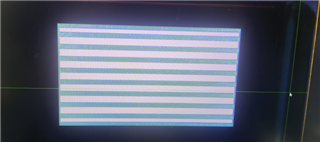

  • Hello Aaron ,
    Regarding the point you mentioned, I can confirm that all our current boards follow the power-down procedure. Even if the customer directly cuts power, the DMD has sufficient time to complete shutdown.
    Additionally, we conducted a test where:
    1. The DMD was powered on and set to cycle stripe pattern projection.
    2. We forcibly disconnected the DMD connector from the DMD board while operating.
    3. The DMD maintains a fixed pattern (see image below), and it can be observed that this does not constitute a complete stripe image.
    After reconnecting and powering on:
    • The DMD booted normally
    • Micromirrors completed reset successfully
    • Could display other patterns normally
    • No additional bad pixels were observed in projected images
    We repeated this test multiple times and consistently confirmed:
    • The DMD never entered a hung state
    • No new bad pixels were generated

  • Hello Junfa,
    Thank your for the additional information, I've reached out to my team for any comment on power but we still have concerns about the seal on the device with the cracks in the glass.
    This is definitely a package failure and pixel failures would be expected.

  • Hello Junfa,
    I understand reading back through the discussion that some units were known to have cracks and were going to have issues. As I've explained before, exposing the mirrors to ambient air will cause them to stick.
    Could you advise how many units you're seeing issues with? Are these previously known issue parts?
    My last comment highlighted that the overfill of light should not be more than ~10% of the active array. The black encapsulated material should not ever have light illuminated on it. This would cause unknown issues and this is outside of specified testing parameters but I'd think the encapsulation material would degrade.
    What kind of investigative FA request were you thinking of submitting for? Both DLP3010LC and DLP4710LC?
    Aaron
  • Dear Aaron,
    Understood and acknowledged.
    Here’s the confirmation:
    1. Failure Quantity: 1 unit each for DLP3010 and DLP4710LC
    2. Root Cause Assessment:
      • Strong correlation with glass damage
      • Excessive light overfill (>10% active array) is the most probable cause
    Regarding FA submission:
    • This request focuses only on DLP4710LC (per this thread’s scope)
    • We’re aware this unit exceeds the 1-year warranty period
    If TI cannot process out-of-warranty FA cases through any alternative channels, kindly advise. We’ll then close this case accordingly. Appreciate your support!
    Junfa Ye

  • Hello Junfa,
    Sorry for the long delay on this, things have been piling up these past few weeks and I had to get more information about this.
    The consensus from my management is that the parts are outside the warranty period and the glass damage is already understood and seen. FA is not going to tell us anything different than what we already know and will not be worth pursuing.
    There are 2 notes I related to this issue and should be fairly straightforward:
    1.  damage on the glass indicates damage on the seal, any exposure to ambient air will cause pixels to stick.
    2. illumination outside of the array area >> 10% overfill and onto epoxy area (encapsulant) and moisture may be being allowed into the package - again causing pixels to stick.
    In summary, the FA for these devices would entirely come back as say "mechanical damage to the window resulted in moisture ingress" and it would be done. There isn't much discovery in the DMDs if they're known to be damaged. If the devices are not visibly damaged FA is more feasible.
    Thank you again for your patience and best of luck on future implementations.
    Aaron
