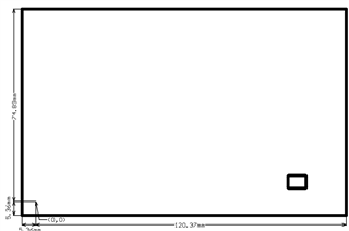

      1. You can see that the board dimensions on our DLP2021AM263Q1EVM, for example, has a cutout in its board geometry for that thermal area where you may connect a thermocouple.  This is taken from the gerber file you may find on the EVM page's design files.

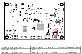

      2. Here is an example of the top solder for your reference. This can be found in the design files on the DLP2021AM263Q1EVM layerPlots PDF.
        Note the mounting holes above and below the DMD area.

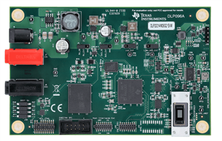

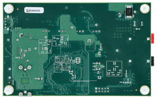

      3. Below are images of the EVM I mention above.

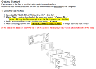

    Just adding to this in case there is confusion in the future. The first image above shows download links for the mechanical-electrical interface, which is how the DMD is mounted to a PCB via a mechanical interface.
    When you download DLPR103, which is our literature number for the assembly, you will see the following when you unzip the archived file:
    Please open the README html file in your web browser.
    Follow the Getting Started directions carefully and use the provided link in step 4 to guide you to another page that shows suppliers of the mechanical components used to attach the DMD to the PCB.
    The link in step 4 from the Getting Started guide leads you to this webpage (local to just your machine because you downloaded our html file)
    This page has additional links to help you order correct parts for attaching the DMD to your board whether it be a custom board or one of TI's EVMs.
