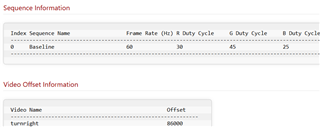

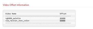

    Just for a sanity check, could you confirm if the Video offset address in the BuildLog.html matches with the Video offset address in the script file?
    This information should be available at the very end of the BuildLog.html file. (in the Build folder)

    Also, I am putting the same offset in BuildLog.html in script file.
    My concern here is the frame rate of 60 fps for Baseline sequence. Whenever, I render custom input video file of 60 fps or 25 fps other than racecar video file (default one), noisy video is displayed despite of correct frame count and address offset .

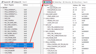

    The problems seems to be coming because of the addressing of the Video Frame Buffer 2.
    Firstly go over to the Default Register Configuration page and check if you have the following configuration added for Video frame buffer 2:
    If this is not added,
    You can add this from the same page.

    I added VCM_START_ADDR2 AND VCM_CONFIG2 as shown below:
    This enabled to display video and image is toggle mode. However, when I tried with image only mode (turning off toggle mode), the image was displayed without noise. But, for video only mode which was configured with  VCM_START_ADDR2 AND VCM_CONFIG2, it still was displaying image only.
