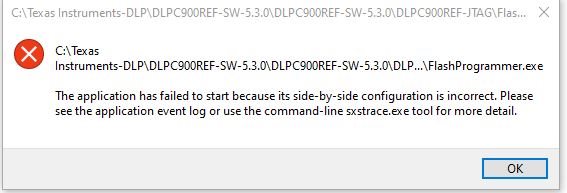

FlashProgrammer included in DLPC900REFSW-5.3.0 failed to start on my computer although it was running fine before March 2025, maybe due to recent Windows updates. My computer now is running Windows 10 with the latest update, our IT department has tried to reinstall different versions of C++ redistributable but there was no luck unfortunately. Below are the screenshot of the error message and my computer specs:
Edition Windows 10 Business
Version 22H2
OS build 19045.6093
Experience Windows Feature Experience Pack 1000.19062.1000.0

  • Hello Hongtao,
    It looks like this user also had the same issue and were able to recover by by installing Microsoft Visual C++ 2005 Service Pack 1 Redistributable (found here).
    We will take a look to see if we can update the tool for the next maintenance release.

  • Hello Aaron and Aishwarya
    Thank you for your reply. Running in administrator mode and installing C++ 2005 Service Pack 1 haven't solved the issue. What other things I can try please?

  • Hello again Hongtao,
    Please uninstall GUI 5.3.x, reboot and then install Microsoft Visual C++ 2005 Service Pack 1 Redistributable again.
    Reboot one more time and then re-install GUI 5.3.x.

  • Hongtao,
    Ti does not share the source code for this.  I need to consult with our software team.  From you description, I assume all of the computers tried were basically identical in origin and configuratioi.
    Please try this sequence.  Uninstall the GUI (5.3) and Microsoft Visual C++ 2005 Service Pack 1 Redistributable then reboot.  Run Microsoft Visual C++ 2005 Service Pack 1 Redistributable as administrator and reboot.  Then install GUI 5.3 again and reboot.  Then see if the JTAG utility still gives the error.
    This occurs when the programmer app cannot find the right redistributed file it is looking for.
    I am very sorry for the issue.
    Fizix
  • Hello Hongtao,
    Could you please run the following on your system? It'll tell you the missing dependency.
    1. Run this command in Command Prompt (Admin): sxstrace.exe trace -logfile:sxstrace.etl
    2. Start the FlashProgrammer.exe (let it fail).
    3. Then stop tracing: sxstrace.exe stoptrace
    4. Parse the log: sxstrace.exe parse -logfile:sxstrace.etl -outfile:sxstrace.txt
    5. Open sxstrace.txt — it will tell you the exact missing DLL/runtime.
    Let us know if you could install/repair the missing files.

  • Hello, Fixiz and Alshwarya
    Thank you for your suggestions. I just solved the issue by installing Microsoft Visual C++ 2005 Service Pack 1 Redistributable 32-bit version instead of the 64-bit version. It is fine to installed the 32-bit version even after DLPC900REFSW-5.3.0 installed.
    I also tried with installing C++ 2015-2022 32-bit, and this hasn't solve the issue.

  • Hongtao,
    Thank you for letting us know.  Yes it must be the 2005 version, not the 2015 version as that is what the GUI was written with.  Good sleuthing on using the 32-bit versus the 64-bit version.
