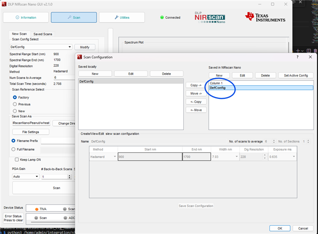

  • Yes.. I have saved and set it as active. But when I connect to RPi4 and run the script, it is not detecting the saved config. The product documentation says export the config but I do not see it in the UI. Please help
  • Shiva,
    I am asking if you use the GUI on a PC can you see the configuration you made and stored.  I want to be sure that it actually saved the solution.
    Fizix
  • ok, yes I do see the configuration that I have saved  when I use GUI on a PC

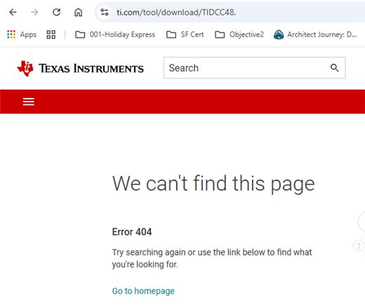

    • Broken link:
    • Please provide a working link or updated doc set.

  • Shiva,
    It is strange that the file is not found since I downloaded it yesterday.  I am going to send you a message via email.

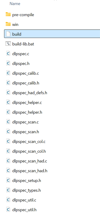

    However, to decode scan data on Linux, I need the DLP Spectrum Library available as a Linux-loadable library (.so) or the C sources so I can build it for ARM. TI has provided headers + a static archive only, which is insufficient.
    1. What I received (no sources):
    ~/NIRScan_Nano_Python/DLP Spectrum Library/src
    Directory contents:
    dlpspec_calib.h  dlpspec_helper.h  dlpspec_scan.h  dlpspec_scan_col.h
    dlpspec_scan_had.h  dlpspec_setup.h  dlpspec_types.h  dlpspec_util.h
    dlpspec_version.h  libdlpspec.a
    There are no *.c files (e.g., dlpspec.c, dlpspec_scan.c, tpl.c, etc.), so I cannot compile a shared object on the Pi

  • Shiva,
    i was under the impression that you had already installed the Spectrum Library.  Please go to this link:  https://www.ti.com/tool/download/TIDCAK0
    When I install this I find the files you listed there:
    Under C:\ti\DLPSpectrumLibrary_1.1.5\src
    Beyond this we do not have resources to go build what you are asking for.  Support is for Windows.
    I know there are files in GitHub that are not officially supported but might be helpful.

    What we need from TI (specific asks)
    • The config export from Windows interface.
     I have tried all options that I can perceive. I just need the config file to make progress with this device. Triggering a scan from a Raspberry Pi is a  crucial component of my research effort. Please help

  • Hello again Shiva,
    From this forum in 2018 this thread  [https://e2e.ti.com/support/dlp-products-group/dlp/f/dlp-products-forum/738328/linux-dlpnirnanoevm-do-you-have-any-libraries-for-linux]  indicates that there is no direct support for Linux, but that USB commands can se sent.
    That thread references this thread [https://e2e.ti.com/support/dlp/f/94/p/538053/1960163_]
    Fizix
