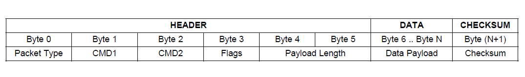

    Again refer to DLPC300 DM365 Command spec the packet structured is

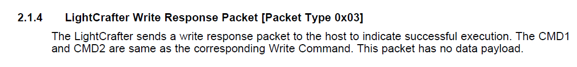

    So for successful write response refer to Command Spec documentation
    there is no payload data, so the response packet will have just 7 bytes i.e., Byte6 will be basically a CHECKSUM value.
    Since you are sending a valid command there is no error happening. And you are reading 7bytes properly. So system will not hang :)
