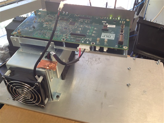

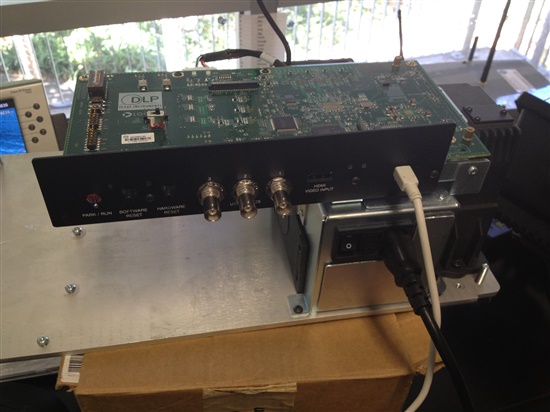

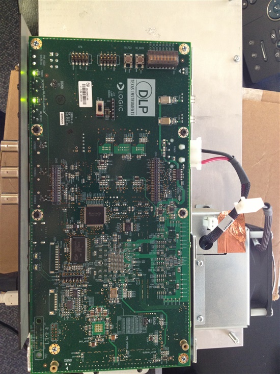

  • Hello Haixing,
    Can you also read ReadReg 0x0C88.
    One more question, is it your self designed board? if it is not, please mention which EVM are you using. We can then determine which schematics.
    Please send the setup picture.
    From your above register value, 0x0C84 = 0x092, I can tell the spi i/f between DLPA200 to DLPC200 looks OK. DLPC200 able to detect DLPA200 properly.
    Now the problem could be one of the following -
    1.  Check if the DMD board is properly connected to the DLPC200 controller board.
    or
     2. At the beginning I suggested you to check "It appears to me that there is a problem with the DMD interface. You also need to make sure the POWERGOOD line to the DLPC200 is HIGH." Did you try this?
    Sanjeev
  • Dear Sanjeev
    Thanks for your reply.
    ReadReg 0x0C88 returns 0x0000001F
    It is the controller board inside the DLP Light Commander.
    I am not quite sure which EVM it is.
    I did not check PowerGood Signal because I don't know where I can measure the voltage.
    Haixing
  • Sorry, I clicked "suggest answer" by mistake. Hope you will not miss the post.
  • Hello Haixing,
    Thanks for posting the pictures. It is the original DLP LightCommander EVM launched at beginning for supporting DLP5500 chipset evaluation.
    Also thanks for sharing the register value; ReadReg 0x0C88 returns 0x0000001F
    Clearly, it is a problem with DLPC200 not able to detect or recognize the DLP5500 DMD part sitting on the DMD board.
    The problem could be one of the below two -
    1. DLP main board not properly interfacing with DMD board. You can try inserting this board firmly again, make sure not loose contact.
    2. The DMD is not properly seated on the DMD board. Try the suggestion discussed in the E2E forum http://e2e.ti.com/support/dlp__mems_micro-electro-mechanical_systems/f/387/t/205459.aspx
    Sanjeev
