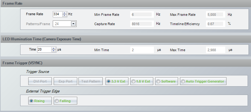

    1. In your timing diagram the period of sample lasting is mentioned as 21us to 3ms. 21us period is not possible, DMD takes about ~200us to load the image data. So your period can be any value within range 0.2ms to 166.67ms.
    2.  At 3ms period you can simply change the LED illumination time to 20us and then build the sequence this will work for you without any additional changes. Attached is the snap-shot of the LightCommander GUI.
    Frame Trigger (VSYNC) can be selected as 'External trigger' or 'Auto-Trigger'.  With 'External Trigger' - your acquisition system can provide the trigger input the system. So the DLP illumination precisely illuminate the sample for 20us after receiving the trigger.
