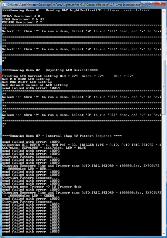

  • Finally we invented a scenario when the projector fails in a program written by TI, LCR_Cmd_Interface.exe.
    Please see the screenshot below.
    It this command sequence work on my machine with my projector, but on their PC with their projector it fails as you can see on the screenshot.
    Now I hope that it will be much easier for you to reproduce the problem.
    The code was compiled from DLP LightCrafter API Sample Code-Windows v2.0
  • Hello Georgy,
    From the log above the error seems to appear when Demo#2 is running.
    The error is described here, connection reset by peer is the error code 10054 (http://msdn.microsoft.com/en-us/library/windows/desktop/ms740668(v=vs.85).aspx)
