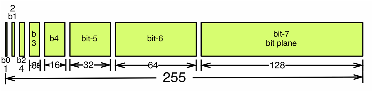

    Let me explain a little more fully. The 8-bit sequence can be represented by the image below. This gives you an 8 bit gray scale image when integrated over the frame. So for full white, the mirror would remain "on" for b0, b1, b2, b3, b4, b5, b6, and b7. The limit for how fast this 8-bit sequence can be displayed is clearly the speed with which the fastest bits can be displayed (b0).
    In our 8-bit sequence, we are able to achieve faster speeds by also modulating the light through a PWM signal. This is able to increase the speed with which the smallest bits are exposed. So, without getting into the specifics of the pattern sequence, for example, b0 can be exposed by switching the mirror to the "on" state and then the exposure can be quickly stopped by turning off the light source, the light source is then turned on to expose the next bit which is already switched into place, and so on. This does introduce some dark time into the 8-bit pattern sequence. The bits are also shown in a more optimized order (i.e. not the b0 - b7 order shown above). Thus we are able to achieve 1,900 Hz 8-bit patterns on the DLP7000.
    Let me know what questions you have!
    Trevor
  • Thats great, thanks trevor. May I ask what datasheet that image came from ? that helped alot.
  • Hi Rob,
    That image appears in several of our datasheets and programmers guides, including the DLPC350 (controller for the DLP4500), and the DLPC900 (controller for the DLP6500 and DLP9000). It is good to know that you found it helpful! We will take a look at getting it added to the DLPC410 datasheet to make it a little easier for DLP7000 users to find.
