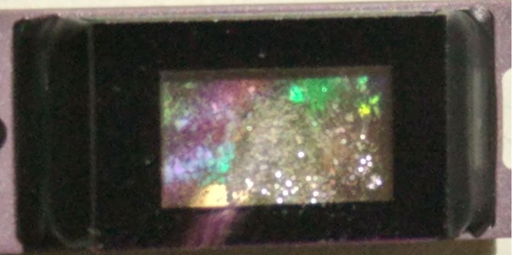

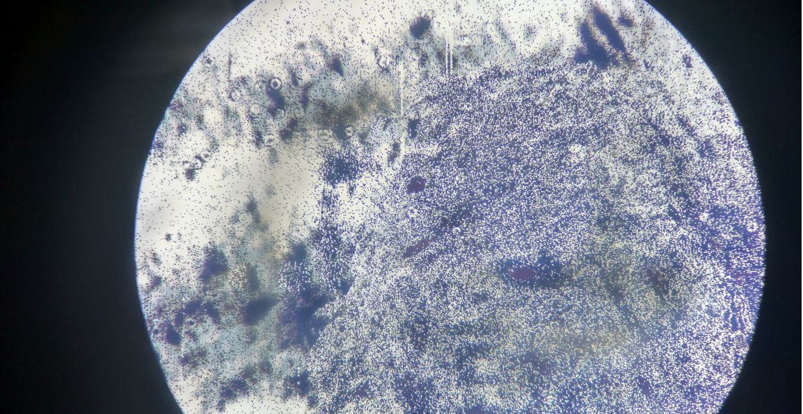

I am a Msc student at Structured light Laboratory, University of the Witwatersrand, South Africa. We are working on an experiment that uses DMD (DLP3000) with flash pumped Nd:YAG laser with an output power of 2.3mW. The DMD was working perfectly as a reflecting mirror (the device not connected to the power supply). As soon we started modulating it, i.e. connected the device to the power supply, and set all mirrors to the off- state, it experienced a huge damage by the laser (Please see attached images).
We do not understand why this had happened and we are still confused about Section 6.4 of DLP3000 DLP 0.3 WVGA Series 220 DMD datasheet (Rev. B) - "Recommended operating conditions" where the maximum illumination for wavelengths of greater than 700 nm is given as 10mW/cm^2. We were definitely not close to this power damage threshold.
Currently, we are suppose to continue the experiment with another DMD, but before that we would like to understand the reasons for this damage so as we avoid it in our experiment?
We would also like to understand:
  • If the thresholds is the same for all of the DMD states, for example if the threshold is the same in the sleep-mode(not connected to power) and in on-state (when mirrors are at angles of 12 degrees).
  • If this threshold is for the average or the peak power?
  • The filling factor in the sleep-mode is around 92%. What is the filling factor for the device in the on-state?
  • Transmission for the window on the micro-mirrors for wavelength 1.64 micrometers is around 78%, so the losses from this window is 22%. What is the percentage of light that got reflected and the percentage got absorbed by the window?
  • What is the power threshold for the silicon substrate under the micro-mirrors?
We greatly appreciate if you can help us to have full understand on how this damage happened. Thank you in advance.

    Welcome to the E2E forums and thanks for your interest in our DLP technology.
    The two DMDs in our portfolio which are designed to operate at these thresholds are the DLP2010NIR and DLP4500NIR. The DLP3000 is intended for visible wavelengths, but I'll check how it behaves beyond that. Thanks for your attention.

    The DLP3000 appears to be intended for visible light applications. Do you still need assistance with this query? If not, I will tentatively close this thread.

    Thank you for your response. According to Section 6.4 of DLP3000 DLP 0.3 WVGA Series 220 DMD datasheet (Rev. B) , there is a stated recommended operating illuminating condition of 10mW/cm^2 for wavelengths greater than 700 nm, which implies that the device should be able to operate at these wavelengths. As we are well below the illumination threshold, I do not understand how the device has sustained damage. I also require assistance on the bullet points mentioned in the first post.
