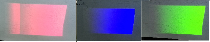

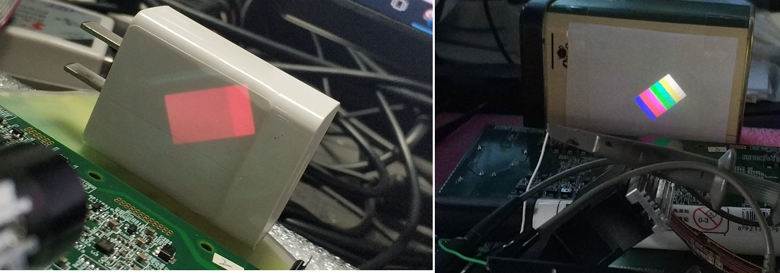

in my system,
we found my dmd can display the really color when use the dlpc's tset pattern(such as aolor bars, as follow pircture).
and can display the really color when use external video port (Parallel Interface,RGB24, when R=0x00,GB=any value)
and can display the really color when use external video port (Parallel Interface,RGB24, when R=0xee or bigger,GB=0x0000)
but can't  display the really color with stripes (as follow picture), when use external video port (Parallel Interface,RGB24, when R=0x88 or smaller,GB=0x0000)

  • 1. i have try the test with my fpga supply the external rgb signals and useing the dlp3010 evm's optical machine.
    it's have the same problem.
    2. i also have the test with imternal dlpc's red-solid-pattern, it's no problem.
    and,i think the pattern is rgb=0xff0000.
    but, with my fpga's external rgb=0xee0000 or bigger, it's no problem also.
    3. could you do the test for me with rgb=0x770000, i think it's only a dmd's bug,ha-ha.
  • i have a test today and find out that:
    when i use the dlpc internal source(Write the Input Source Select (Register:05h)to (1h: Test Pattern Generator))
    and i set the Test Pattern Select (Register:0Bh) to { 0x1(Fixed step horizontal ramp) 0x10(Red) 0x40(star) 0x40(end) 0x80 0x80 }
    i find out the same red stripe as the above picture.
    so i think, our fpga has no problem.
    something is wrong with dlpc or dmd.
    thanks a lot.

    the problem is listed as follow.
    and  set the Test Pattern Select (Register:0Bh) to { 0x1(Fixed step horizontal ramp) 0x10(Red) 0x40(star) 0x40(end) 0x80 0x80 }
    also, you can set the color as green(0x20) or blue(0x30).
    we find out two problems, as follow picture.
    1)  all of the color is not displayed with Fixed Step Horizontal Ramp(not digital step down),
        but is analog step down without the clear strips.
        but this problem is not important, i think is only a internal setting of the dlpc.
    2) the important problem is my issue question.
    when use the red color, you can clearly find out the dmd is separated by two parts.
    but the green or the blue is ok.

  • hi philippe,
    i have visited the ti's shanghai office.
    kevin shi give me some new images to try to resolve the problem.
    and it's very sorry, it's cann't work ok still.
    but,kevin's image can work ok with your evm board
    (the evm is dlp3438+dlpa2005+DLP3010FQK).
    but my two systems all are cann't work ok.
    (my old system is DLPC3438CZEZ+DLPA2000DYFFR+DLP3010FQK).
    (my new system is DLPC3438CZEZ+DLPA2000DYFFR+DLP3010AFQK).
    i have replaced the dmd because the old one is NRND.
    so,pls your to check the image must with DLPA2000DYFFR.
    and i find out something is different between DLP3010FQK and DLP3010AFQK,
    so,pls your to check the image must with DLP3010AFQK.
    and it's very strange,my system cann't reappear the same error pattern as the above picture,
    regardless of useing the every version of image from kevin or Navneet.
    i think may be i have switched the dmd(DLP3010AFQK)?
    or the LOOKs(write parameters) or somethings have be changed in my flash or in the dlpc ?
  • Jianyuan,
    After some delays, I was able to set up a system to match your system configuration.
    Using the provided dlpc3438 firmware that you provided, I was able to reproduce the issue you are seeing. As such, I believe the issue you are seeing lies with your firmware, not with your hardware. Where did you get this firmware? I recommend you use a fresh firmware installation.
