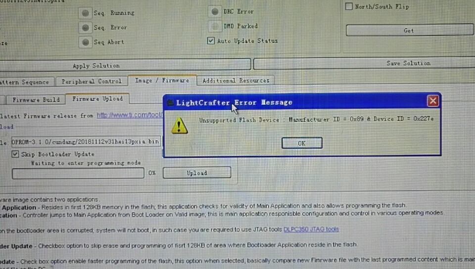

Dear TI Experts
According to the DLPC350 reference design, M29DW128GL70N (Flash) is used~ now we find that M29DW128GL70N is not easy to bought and decide to change to MT28EW128A
but we meet with below problem:
"Unsupported flash device" do you have any suggestion to this problem?

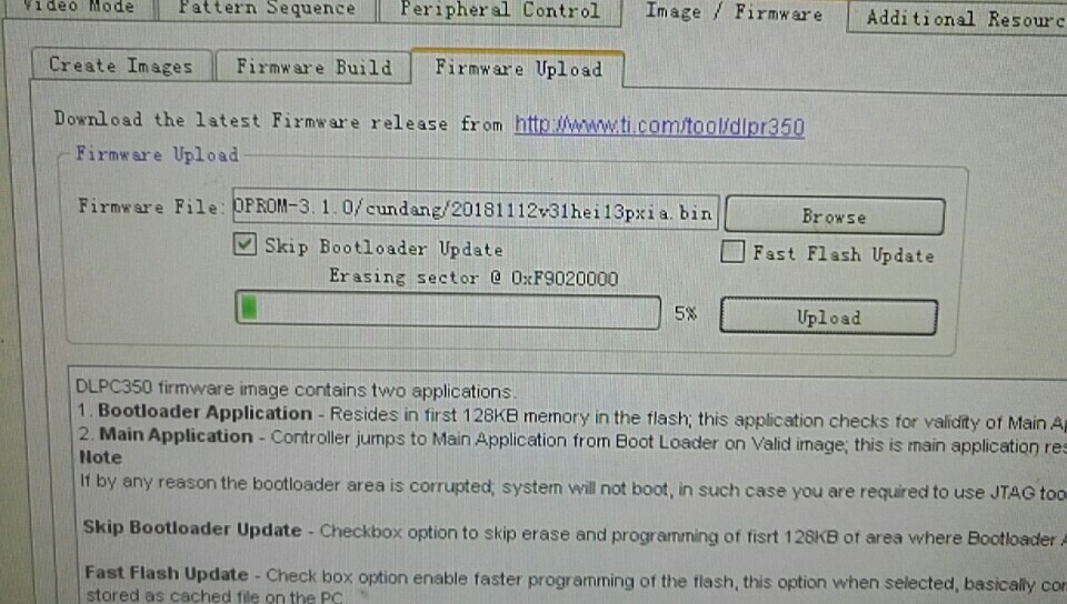

  • Hello Kyle
    Can you help recommend one flash that TI GUI can support?
    Or could you tell me what the requirment of the flash?
    When using the new flash,There's no problem with burning and system booting.
    Their is an error report when upgrading with TI upgrade tool.
    So I'd like to know the flash list that TI GUI supports~
  • Hi Qianqian,
    The DLP4500 GUI uses a text file named "FlashDeviceParameters.txt" to identify the Flash part used. This text file is located in the installation directory of the GUI software.
    To use the MT28EW128A flash part, you need to add this part to the text file. To do this, follow these steps:
    1. Close the GUI
    2. Open the "FlashDeviceParameters.txt" file and add the following line at the bottom of the file:
    "Micron",   0x0089, "MT28EW128", 0x227E, 128, 0, 0x1000000, 128, 0x0, 0x20000, 0x40000, 0x60000, 0x80000, 0xA0000, 0xC0000, 0xE0000, 0x100000, 0x120000, 0x140000, 0x160000, 0x180000, 0x1A0000, 0x1C0000, 0x1E0000, 0x200000, 0x220000, 0x240000, 0x260000, 0x280000, 0x2A0000, 0x2C0000, 0x2E0000, 0x300000, 0x320000, 0x340000, 0x360000, 0x380000, 0x3A0000, 0x3C0000, 0x3E0000, 0x400000, 0x420000, 0x440000, 0x460000, 0x480000, 0x4A0000, 0x4C0000, 0x4E0000, 0x500000, 0x520000, 0x540000, 0x560000, 0x580000, 0x5A0000, 0x5C0000, 0x5E0000, 0x600000, 0x620000, 0x640000, 0x660000, 0x680000, 0x6A0000, 0x6C0000, 0x6E0000, 0x700000, 0x720000, 0x740000, 0x760000, 0x780000, 0x7A0000, 0x7C0000, 0x7E0000, 0x800000, 0x820000, 0x840000, 0x860000, 0x880000, 0x8A0000, 0x8C0000, 0x8E0000, 0x900000, 0x920000, 0x940000, 0x960000, 0x980000, 0x9A0000, 0x9C0000, 0x9E0000, 0xA00000, 0xA20000, 0xA40000, 0xA60000, 0xA80000, 0xAA0000, 0xAC0000, 0xAE0000, 0xB00000, 0xB20000, 0xB40000, 0xB60000, 0xB80000, 0xBA0000, 0xBC0000, 0xBE0000, 0xC00000, 0xC20000, 0xC40000, 0xC60000, 0xC80000, 0xCA0000, 0xCC0000, 0xCE0000, 0xD00000, 0xD20000, 0xD40000, 0xD60000, 0xD80000, 0xDA0000, 0xDC0000, 0xDE0000, 0xE00000, 0xE20000, 0xE40000, 0xE60000, 0xE80000, 0xEA0000, 0xEC0000, 0xEE0000, 0xF00000, 0xF20000, 0xF40000, 0xF60000, 0xF80000, 0xFA0000, 0xFC0000, 0xFE0000,
    3. Save the file and close it.
    4. Re-start the GUI.
    The GUI should now be able to detect the flash part.

  • Hello Azad
    It's really kind of you to tell me this~
    I have tried your methods,but It's stuck here all the time, do you have any suggestions?Thank you very much~
  • Hi Qianqian,
    That sector doesn't exist in this flash part. Looks like the GUI isn't configured correctly. Can you uninstall the GUI and re-install the latest version from ti.com? Then, clear the content in the FlashDeviceParameters.txt and add only the line mentioned above in my previous post.
    Azad
