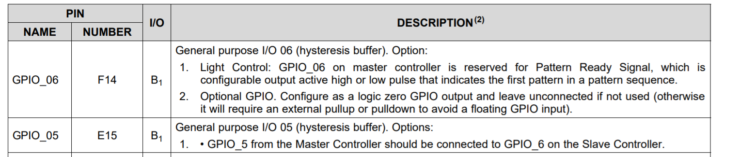

    I noticed one schematic difference is GPIO5 and GPIO6 between the DLPC3439 and DLPC3479, could you confirm what do GPIO5 and GPIO6 means?
    I can confirm I am using the version of firmware is "DLP4710EVM-LC_Firmware_1.1.0.img".
    I understand the DLP4710EVM-LC is the best choice for DLPC3479 and we will develop DLPC3479 follow DLP4710EVM-LC.

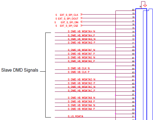

    Another question, why I could not find the schematic for DLP4710, because I found the connection are different from DLPC3439 or DLPC3479 to DLPC4710 as the screenshot.
    Best Regars,
    Kelly
  • Hello Kelly,
    You can find a description of the two GPIO signals in the DLPC3479 datasheet. They are needed for controller synchronization.
    The DLP4710EVM-LC and DLPDLCR4710EVM-G2 both use pin mapping option 2. The original DLPDLCR4710EVM uses pin mapping option 1. I wouldn't expect any of these changes to affect boot-up though.

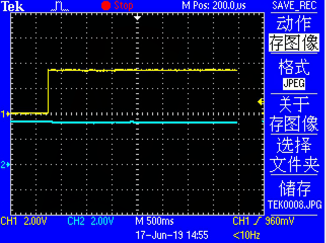

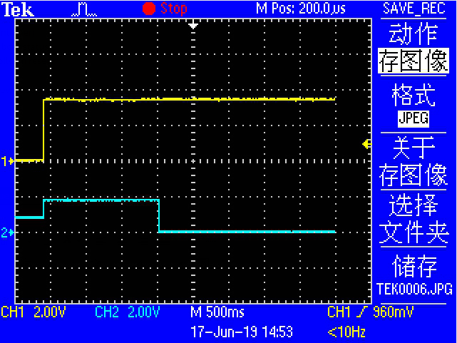

  • Hello Kyle,
    I captured some screenshot of oscilloscope as the below pictures.
    Channel 1 is the signal of PROJ_ON. Channel 2 is the signal of PARKZ.
    Channel 1 is the signal of PROJ_ON. Channel 2 is the signal of M_HOST_IRQ.
    Channel 1 is the signal of PROJ_ON. Channel 2 is the signal of S_HOST_IRQ.
    Channel 1 is the signal of PROJ_ON. Channel 2 is the signal of RESETZ.
    Channel 1 is the signal of PARKZ. Channel 2 is the signal of RESETZ.
    I think the trouble is DLPC3439 could not boot-up, because the signals of M_HOST_IRQ and S_HOST_IRQ are always high level.
    I look forward to your further suggestions.
