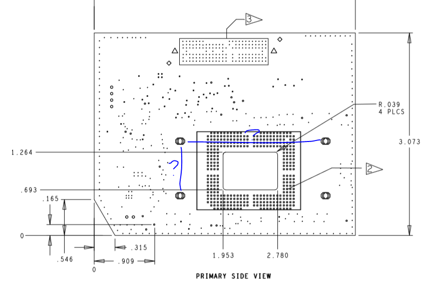

Hi E2E,
Good day.
What is the exact distance between the four holes in the EVM? Thank you.
Carlo
  • Hello Carlo,
    The distances are 21.0 mm and 56.0 mm
    Please refer the the Design Files found here:DLPLCR6500EVM Design Files - Look under "3_CAD_Files\Board Layouts\2511980_LCR6500_DMDBOARD_P65_1080P_S600_CSTACK_FLEX_CONN.zip".
    Which should have the file "2511980_LCR6500_DMDBOARD_P65_1080P_S600_CSTACK_FLEX_CONN.brd" inside.  This file can be viewed with Allegro Free Physical Viewer.  Using the measure tool you can extract almost any measurement you need.
