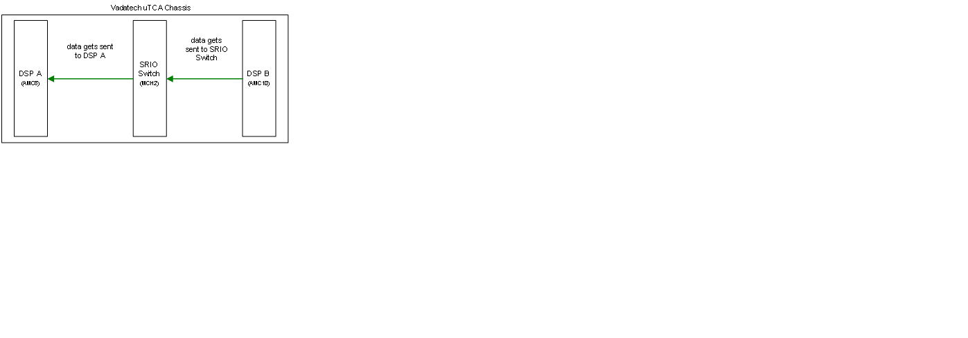

    The way I use SRIO is with a direct write to memory.  To test without my FPGA, I got a second EVM and created a test program to write to the memory of the first EVM.
    The only way to know that the data was written is to have DSP B send a doorbell to DSP A when it is finished writing data.  There are some registers that can be polled too, you can find them in the SRIO configuration doc, sprugw1a.  You can then either write a program for DSP A to verify that it got the correct data or just look at the memory location and see that it is correct.
    Like this:
