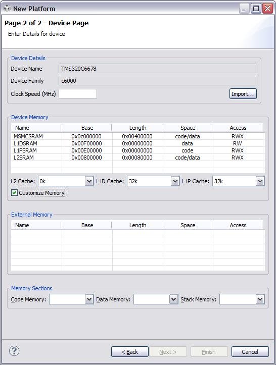

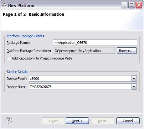

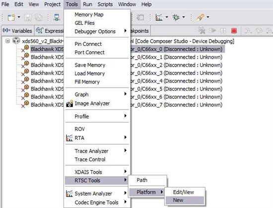

    There are two parts to this. First you need to define memory sections in your RTSC platform file for your application. You can do this by using the RTSC Platform Wizard in built into CCS. Here's the process:
    1. Go to CCS Debug View and Create New RTSC Platform as shown in this snapshot below
    2. Select Architecture and Provide Name

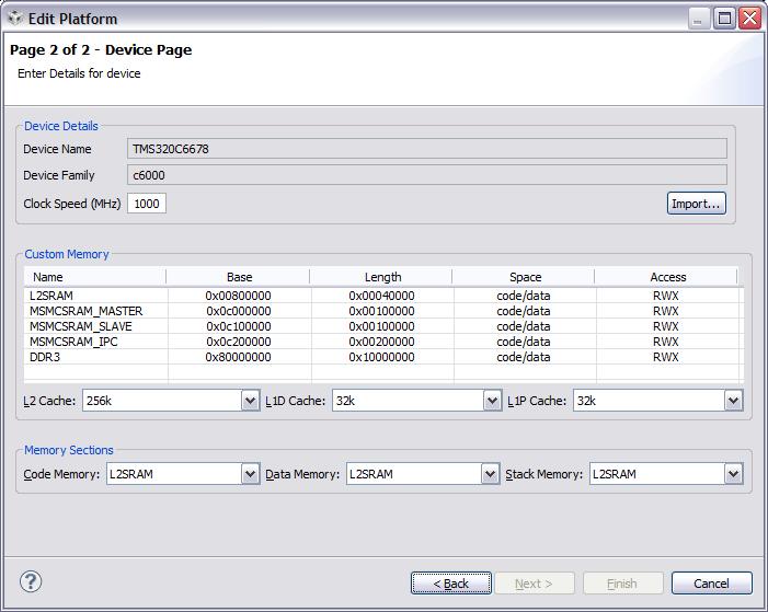

    3. Default Memory Map that is provided. Check the "Customize Memory" checkbox and edit the memory map as required.
    4. For example, in the case of the image processing demo (included in the Multicore Software Development Kit (MCSDK)), the platform is defined as follows:

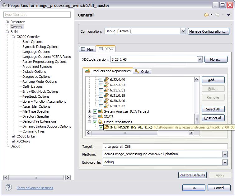

    5. Once you have done this, you will need to point to this platform in your project properties. For example, if we look at the project properties of the image processing demo, you will see this platform is selected under General Properties --> RTSC -> Platform, as the snapshot below indicates. Here you see the platform selected has a platform name "demos.image_processing.ipc.evmc6678l.platform" which was saved in the MCSDK install directory (TI_MCSDK_INSTALL_DIR). So that your platform shows up in the drop-down menu, add the path to your platform by clicking on "Add." Then you will be able to select your platform from the drop-down menu.
    6. Now that the platform is defined, you can use the section names that were you defined in the RTSC platform file and refer to them in your .cfg file (aka RTSC configuration). For example, look at the configuration file "image_processing_evmc6678l_master.cfg" in the image processing demo project. You will see that the sections for .bss, .neardata, etc. are defined here and point to the memory sections defined in the RTSC platform file:
    Program.sectMap["systemHeapMaster"]     = "DDR3";
    Program.sectMap[".cinit"]               = "MSMCSRAM_MASTER";
    Program.sectMap[".const"]               = "MSMCSRAM_MASTER";
    Program.sectMap[".text"]                = "MSMCSRAM_MASTER";
    Program.sectMap[".far"]                 = "L2SRAM";
    Program.sectMap[".bss"]                 = "L2SRAM";
    Program.sectMap[".rodata"]              = "L2SRAM";
