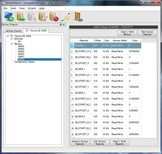

I want to evaluate PCIe communication with windows PC.
I'm using "pdk_C6657_1_1_2_6\packages\ti\drv\exampleProjects\PCIE_exampleProject",
and build EP mode.
I develop windows driver by "http://www.xlsoft.com/en/products/jungo/windriver_usb_pci_driver_development_software.html".
But there is no information for this evaluation.
Could you tell me evaluation board setting (FPGA, Dip switch) , implementation, or some information.

  • Dear Eric,
    I appreciate the support.
    I was able to read configuration space, interrupt, and memory.
    Additionally, I want to know the currently-running program code.
    I think example code is different from this evaluation environment.
    Where can I find the program code? ("mcsdk_2_01_02_06\tools\boot_loader\examples\pcie" ?)
    And, what can I do in this evaluation environment?
    Best
     regards, Shingo.

  • Dear Eric,
    I understood boot_loader\example\pcie*
    They are converted into header-file (***.h), and loaded from PC to DSP by PCIe.
    Now, I access by Windows-PC.
    And I'm able to read configure registers.
    For example, BAR3 is 0xD000 0000 - 0xD0FF FFFF, and BAR0-5.
    But Linux PC is read BAR0,1,2,3. and area is internal memory (Local L2 SRAM etc...)
    I'm able to write 0xD000 0000 (DD3 area), but can't write internal memory.
    How can I access ?
    Additionaly, I over write i2c eeprom memory (0x51, 0x50).
    Then, I can't access PCIe. Maybe PCIe boot is not running.
    I want to rewrite correct i2c-eeprom binary.
    With some eeprom binary, can't running PCIe boot.
    (mcsdk_2_01_02_06\tools\program_evm\binaries\evm6657l)
    Where is the correct binary ? Please help.
    Please help
    Best regards, Shingo.
  • You need to re-flash the EEPROM 0x51 address with the correct IBL code to make sure PCIE can be enumerated. Look at \ti\mcsdk_2_01_02_06\tools\writer\eeprom\docs for steps.
    To access the different DSP internal regions, you need to program the inbound translation registers of the DSP PCIE, which can be done on PCIE RC driver side. See the code like:
       /* Configure IB_BAR0 to BAR0 for PCIE registers; Configure IB_BAR1 to BAR1 for LL2 for core 0
         Configure IB_BAR2 to BAR2 for MSMC; Configure IB_BAR3 to BAR3 for DDR */
      for (i = 0; i < 4; i++) {
       iowrite32(i, ptrReg + IB_BAR(i)/4);
       iowrite32(PCIE_DEV->resource[i].start, ptrReg + IB_START_LO(i)/4);
       iowrite32(0, ptrReg + IB_START_HI(i)/4);
      iowrite32(PCIE_BASE_ADDRESS, ptrReg + IB_OFFSET(0)/4);
      iowrite32(LL2_START + (1 << 28), ptrReg + IB_OFFSET(1)/4);
      iowrite32(MSMC_START, ptrReg + IB_OFFSET(2)/4);
      iowrite32(DDR_START, ptrReg + IB_OFFSET(3)/4);
    Regards, Eric
  • Dear Eric,
    I understood pcie_boot.
    I'm extremely grateful for many support.
    I was able to restore evaluation board.
    Setting of some inbound tranlation, I was able to access internal memory (Read/Write).
    By the way, where is the code of this pci boot code.
    I want to know initialize sequence of PCIe.
    I want to run my setting (Vendor ID, BAR etc...)
    Best
     regards, Shingo.
