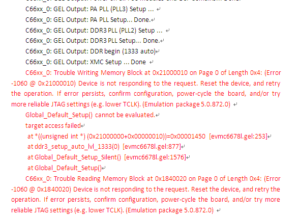

Hi All:

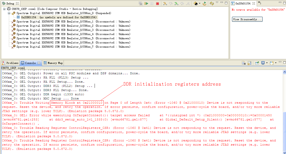

The problem about connecting C6678 core0 on our custom board has been solved after we modified the reset process.But there are some other problems.Firstly, we are not sure the connecting state is whether right or wrong.And we still cannot inialize some interfaces e.g. DDR  and SPI.
1.this is the state we successfully connected core0,but  we are not sure it is right or wrong
2.we read some state registers after we connected core0, and the value of address 0x023100e4 is different from what is read from our normal board.What does the value mean?Is it related with our errors?
3.When we initialized SPI or DDR,the errors come.What does it mean?

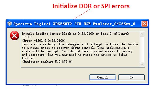

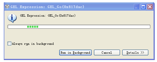

4.By the way ,when we debug  using "run to line" ,it pop-up a dialog as follows.What does it mean?We did not use gel files,so where is the GEL application?
5.The word file is the result we run the gel file alone on the abnormal board and a normal board.Though the parameters are not   entirely match with our board,it should not go to dead. Is it possible the chip is bad?

  • Hi Shankari,
    Thanks  for your reply!
    I did following your step, but because of the connecting errors I didn't provide the gel file path for core0.Instead, after connecting core0,I right click on the target and choose "Open the GEL Files View ",then I choose "Load GEL ..".Finally,I choose "Scripts"->"EVMC6678L Init Fuctions"->"Global_Init_Setup".
    Here is the result,and you can get more details in the word file I upload including  running on the normal board.
    And when we use our application to initialize the interface(SPI/DDR) instead of the gel file,the error dialog pop-up.
    And the errors only happened on the core0,we can successfully initialize the interface(SPI/DDR) on other cores.
    Can you tell me why?Is it possible the chip is bad?
    Eagerly awaiting your reply !

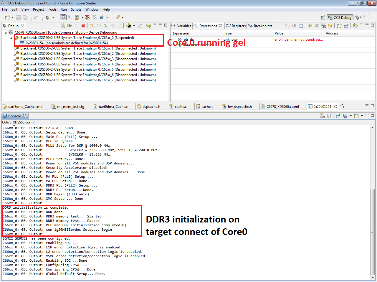

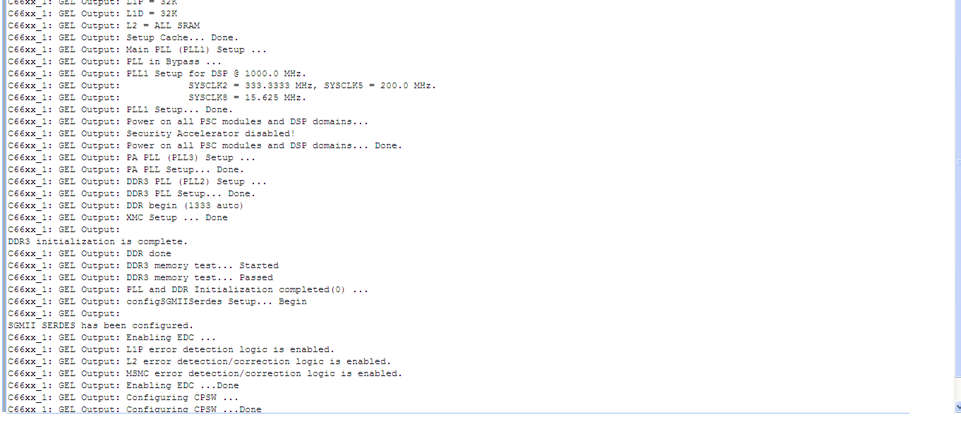

    I have reviewed the attached doc file, it seems that your DDR fails on test or the initialization failure.
    2. core0 runs the gel on the normal board,though the parameters are not entirely match with the chip
    C66xx_0: GEL Output: Setup_Memory_Map...
    C66xx_0: GEL Output: Setup_Memory_Map... Done.
    C66xx_0: GEL Output: C6678L GEL file Ver is 2.004
    C66xx_0: GEL Output: Global Default Setup...
    C66xx_0: GEL Output: Setup Cache...
    C66xx_0: GEL Output: L1P = 32K
    C66xx_0: GEL Output: L1D = 32K
    C66xx_0: GEL Output: L2 = ALL SRAM
    C66xx_0: GEL Output: Setup Cache... Done.
    C66xx_0: GEL Output: Main PLL (PLL1) Setup ...
    C66xx_0: GEL Output: PLL in Bypass ...
    C66xx_0: GEL Output: PLL1 Setup for DSP @ 1000.0 MHz.
    C66xx_0: GEL Output:            SYSCLK2 = 333.3333 MHz, SYSCLK5 = 200.0 MHz.
    C66xx_0: GEL Output:            SYSCLK8 = 15.625 MHz.
    C66xx_0: GEL Output: PLL1 Setup... Done.
    C66xx_0: GEL Output: Power on all PSC modules and DSP domains...
    C66xx_0: GEL Output: Security Accelerator disabled!
    C66xx_0: GEL Output: Power on all PSC modules and DSP domains... Done.
    C66xx_0: GEL Output: PA PLL (PLL3) Setup ...
    C66xx_0: GEL Output: PA PLL Setup... Done.
    C66xx_0: GEL Output: DDR3 PLL (PLL2) Setup ...
    C66xx_0: GEL Output: DDR3 PLL Setup... Done.
    C66xx_0: GEL Output: DDR begin (1333 auto)
    C66xx_0: GEL Output: XMC Setup ... Done
    DDR3 initialization is complete.
    C66xx_0: GEL Output: DDR done
    C66xx_0: GEL Output: DDR3 memory test... Started
    C66xx_0: GEL Output: DDR3 memory test... Failed

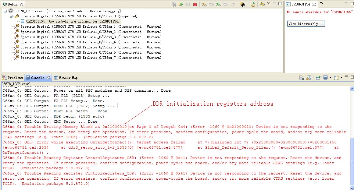

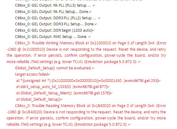

  • Hi Raja and Shankari G,
    Thanks for your reply !
    We modify the parameters about DDR and provide the gel path for core0 according to your advices.And we find the result of initialization on the other custom board is successful but the errors still happen on the abnormal board.By the way,the types of DDR and FLASH are same between the two board.
    The errors:
    We find the error happend when the gel writes the memory of DDR initialization registers.Why?

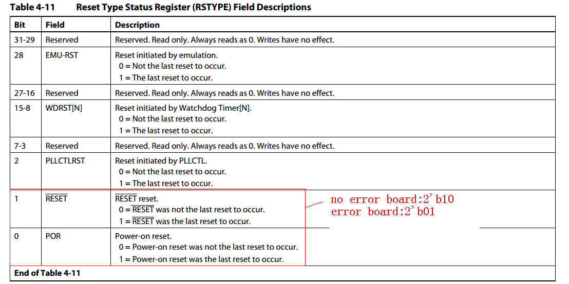

    We check the PLL intialization registers and find different values in address 0x023100e4 between the successful board and the error board.We find the register in the PLL User's Guide .
    What is it mean the RESET bit and POR bit?Is it related with the errors cannot write the DDR initialization registers?
    Eagerly awating your reply !
  • Got the DDR  memory test passed after your modification? If Yes, please share complete console messages as above.
    Thank you.
  • What is the difference between abnormal and normal board?
    In my understanding, both are not working (abnormal).
    As per your log 1) It fails to write DDR registers.
    As per your log 2) It succeed with init and fails on DDR memory testing.
    Please attach the gel file used for connecting with core here for review.
    Thank you.

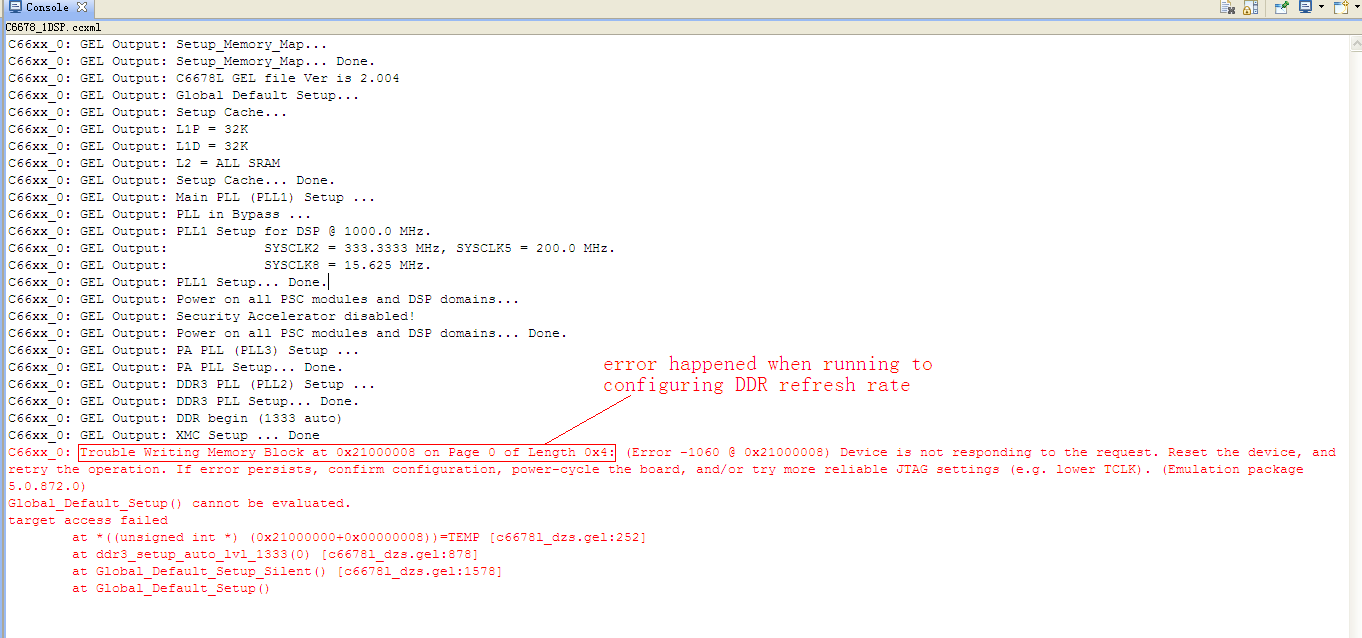

  • Hi Rajasekaran K:
    Firstly ,thanks for your replies!
    I have onced mentioned that I modified the gel file and provided path to core0 on our normal and abnormal board.I also canceled the  "DNUM" limitation,so the "Global default init setup " can run on any core.
    Here is the complete message .
    1.we provide the gel path for core0 on normal board and core1 on abnormal board,the console is same.
    2.we provide the path for core0 on abnormal board,the errors what is can not write the registers happend when gel configuring DDR refresh rate.And if we delete the configuring refresh rate code,the same errors(cannot write the register) happend when running the next code.
    We have checked our board design and nothing found.Why the error happend?
    The "c6678l_dzs.gel file is my modified one .And   ""gel_console.docx " is the complete message we got from gel initialization.
    Eagerly awating your reply!

  • Hi Jie,
    Based on the results that you are seeing it appears that you do not have a stable DDR3 interface. This can be caused by a number of factors on the board. Some of these factors include the stability of the power supply, jitter on the DDR reference clock or DDR3 layout issues. It could also be caused by a problem with configuration. Since that is the easiest to fix, lets look at that possibility first.
    Can you provide the RegCalc and PhyCalc spreadsheets that you modified for your design. Can you provide the length matching information for the layout of your board? You mentioned that you are using the same memory parts as the EVM could you provide exact part numbers you have on your board? Can you provide some details on your board such as the number of layers, the stackup and the layers used for routing the DDR3 interface.
    You also talk about a normal board and an abnormal board. What is the difference between these two boards?
