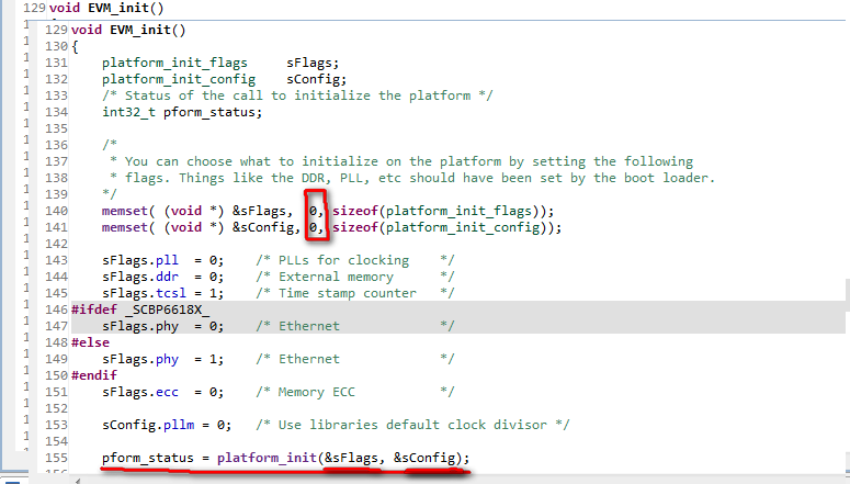

  • I have correct the "if (0)" in helloworld.c to "if (1)", still not work. another stange thing is only when I attached the port1(the upper one), the evm_init() can be successfully, does this matters????

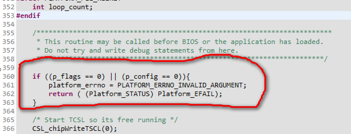

  • My problems has been resolved.  the picture below is the wrong place. In the HelloWorld example, the  sConfig  is set to 0,   but in platform_init() function, it says, if one of sFlags and sConfig is 0, It will return error. So my solution is to set the sConfig.pllm to 1.
