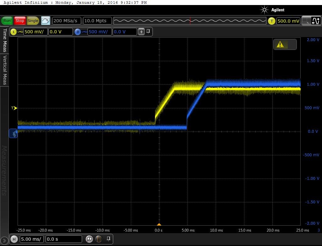

  • Hi Tom,
    I had removed the C6670 and debug the UCD9222+UCD7242 with 500 Ohm resistor as the UCD7242's output load. And the CVDD and CVDD1 are OK as follow
    The yellow line is CVDD with 0.95V and the blue line is CVDD1 with 1.0V.
    So I think the UCD9222+UCD7242 work well to generate CVDD and CVDD1. The schematics is 8371.CVDD_CVDD1.pdf
    But after I solder one new C6670 chip(with the lot trace of YB20 not YB20C)  and before the board is powered up, I measure the resistance between either CVDD or CVDD1 and GND is 0.2 Ohm and I got the value of 0.2 Ohm when I directly touch the two probes of the hand-held multi-meter together. So I think there is something wrong about this C6670 chip. The same question is in e2e.ti.com/.../484532.
    For comparison, I got the resistance between CVDD and VSS is about 10 Ohm and resistance between CVDD1 and VSS is about 16 Ohm on EVM6670L.
    So I think the 0.2 Ohm of either CVDD or CVDD1 to GND is not normal. Am I right?
    Furthermore, when I powered up the board, the UCD7242 reports FLT to UCD9222.
    1. I mean that the UCD9222+UCD7242 work well  on my custom board without C6670 soldered. After C6670 is soldered, however, the UCD7242 reports FLT. I think it must be short and the current ramps too high to reach the UCD7242's limits and then UCd7242 reports FLT. Am I right?
    2. I had used two C6670 on my custom board, I met a very strange phenomenon. When the first C6670 is used, I got the value of 0.2 Ohm between CVDD1 and GND. And after I powered up the board, the resistance remained  around 0.2 Ohm. But after I did some changes about the UCD9222's configuration, the CVDD1 is OK and then I got the resistance of CVDD1 and GND is around 16 Ohm.
    I mean that the resistance between CVDD1 and GND is 0.2 Ohm at first time. However, I got the new resistance value of 16 Ohm after I did the configuration changes of UCD9222. Is it normal? I can not reproduce this phenomenon after I soldered one new C6670 chip.
    3. All these questions are under the condition that I used the C6670 with YB20 as lot trace. But I think the YB20C(as indicated in the table 1 of C6670's errata) is normal. So please help me to confirm C6670 with YB20 is OK or not. The same question is in e2e.ti.com/.../484532.
    Feng
  • Feng,
    1.  Using a 500-ohm resistor is not a real load for this design.  You need a load on CVDD in excess of 5A.  I recommend that you attach a 1-ohm resistor to CVDD1 and multiple 1-ohm resistors on CVDD.  Alternately, there are programmable-load test devices that can be used.  You should validate power supply operation with real loads.  Power supply stability should be tested with a programmable load that can be transitioned on and off rapidly.
    2.  I have no idea why the resistance measured on the multi-meter changed.  I do not expect CVDD1 to have an extremely low value like CVDD.  Perhaps this is indication of an intermittent short on the PCB.  What do you see on your EVM with CVDD1 when using your multi-meter?
    3.  The '20' in the 2nd row on the chip lid indicates that it is PG2.0.  If you are concerned about the validity of the samples purchased, I recommend that you buy a few more.
    Tom
