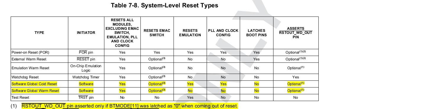

  • Viet
    is following formla working only at watchdog overflow reset function? how about wdout as software reset? is following formula applicable as software reset? wdout signal can be observed as software reset according to table 7-8.  but we can not notice plus width change even we  PRM_RSTTIME.RSTTIME1  as software reset.
    WDOUT pulse width = 300 ns + RSTTIME1 * 1 cycle of SYS_CLK in ns
    BR
    dong

  • Hi Guan,
    In DM814x, we can NOT control RSTOUT_WD_OUT signal duration by RSTTIME1 and RSTTIME2 bit fields from the PRM_RSTTIME register, when the reset is generated from software global cold/warm reset.
    When reset is generated from software global warm reset, PRM_RSTCTRL[0] RST_GLOBAL_WARM_SW = 0x1:
    - RSTTIME2 value has no impact
    - RSTTIME1 value has no impact
    - RSTOUT_WD_OUT is 750ns
    When reset is generated from software global cold reset, PRM_RSTCTRL[1] RST_GLOBAL_COLD_SW = 0x1:
    - RSTOUT_WD_OUT is 800ns
    Make sure the reset is generated from the Watchdog timer, not from global reset.
