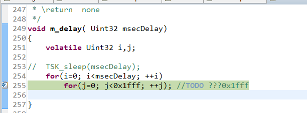

Everyone:
I use the RTFS system to read and write SATA on the OMAP-L138 board. And I use bios_5_41_13_42, rtfs_1_10_02_32, pspdrivers_01_30_01.
When I do the ATA_DrvInit() , I stucked in the ATA_SubmitIdentify() function:
pReq -> Retry   = 10u;
ATA_SubmitReq (pDevice, pReq);
while (pReq -> Retry != 0)
      //PAL_osWaitMsecs (1u);
      m_delay(1u);
      //pReq -> Retry--;
I find other codes alike in the ata.c, as following:
static Int32 ATA_MaxLba (ATA_Drive_t *pDevice)
  ATA_Dev_Req_t *pReq = NULL;
  ATA_Dev_Stat_t Status;
  Int32 retVal = ATA_ERR_GEN;
  if(NULL != pDevice)
        retVal = ATA_NO_ERR;
      pReq = ATA_AllocReq (pDevice, False);
      if (pReq != NULL)
        pReq -> MediaHandle = NULL;
        pReq -> IsInternal  = True;
        pReq -> Command . Device = pDevice -> Dev;
        pReq -> Command . Cmd = ATA_READ_MAX_SECT;
        pReq -> Buffer = NULL;
        pReq -> Mode = TASKFILE;
        pReq -> Res . IsEvent = False;
        pReq -> Handler = &ATA_IdentHndlr;
        pReq -> ToHndlr = &ATA_IdentHndlr;
        pReq -> Timeout = ATA_ONESEC_TO;
          m_delay(1u);
        Status = pReq->Status;
So how the value of pReq -> Retry changed?
