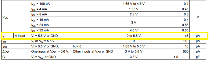

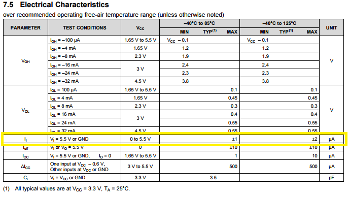

Hi Daniel,
thanks for your reply,
But i was confused whether its is input current or leakage current, becuase some of the datasheet Il is mentioned as input leakage current.
we have checked the same datasheet part number for NXP(74LVC1G34) they have mentioned Il is leakge current.
could you please confirm.
