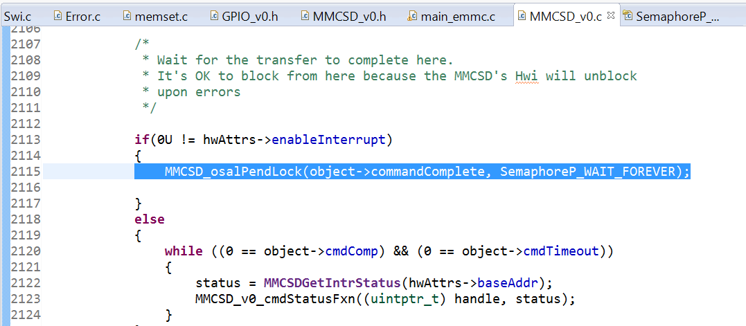

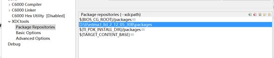

For the DMA version, I set
After building and run, when the program runs into "retVal = MMCSD_write(handle, &tx[0], blockNum, TESTSECTORS);", the program stuck at it.
I stepped into the program, and find the program stuck at here: The 1st call of MMCSD_osalPendLock() in the MMCSD_v0.c.
Attatched are the nonDMA version and DMA version projects I use.
Q1: What's wrong with the DMA version?
Q2:Or can TI provide me a DMA version with Interrupt enabled that suit for C6748+eMMC, which can work normally?
Q3: With the nonDMA(polling or interrupt) version. If I takes 2 MMCSD_write() one after another without delay. The program will stuck at the MMCSD_write(). A delay(10) between the 2 MMCSD_write()  will make it work.
       Is there mechanism that guarantee the MMCSD is ready before another access is taken out? Such as a ready flag? So that the nonDMA version can be used freely.
