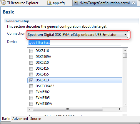

  • You can always download the latest version of CCS and utilize the "Free" license when setting it up.  The free license is fully operational in all aspects, with the exception that it will only work with on-board emulation (i.e. which is present on your c6713 DSKs) and with XDS100 class emulators.
    You would setup the target configuration file (File -> New -> Target Configuration) like this:

  • If you're using CCS with a c6713 EVM then JTAG emulation is involved.  The question here is whether you're using the on-board jtag emulation  (i.e. by plugging a USB cable directly from your PC to the board) or if you're using some kind of separate emulator.  If you want to use the free version of CCS then you are required to use the integrated on-board JTAG emulation.
    Bottom line: Assuming you want to use the free version of CCS then plug the USB directly from your PC to the c6713 EVM and setup CCS using the configuration shown in the "verified answer" in this thread.
