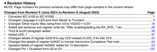

  • Hello Evan,
    I appreciate your quick response.
    Yes, I have received the exact value (0xA240) that you mentioned above.
    => mii read 1 0x0003
    A240
    We are using the latest revision of the IC, which is revision G, as confirmed by the date codes. Additionally, I checked the datasheet, and revision G is mentioned there.
    I am uncertain as to why we are still receiving Revision A data while reading from register 0x003. Could you please provide some insights into this issue?
    Thank you,
    Rohith
  • Hi Rohith,
    Datasheet revision history and dates do not correspond to PHY revision in this case.
    We only expect 0x3 = 0xA240 (rev A)  for DP83822 ICs released to market. Sorry for the confusion here.
    Could you please help me understand any functional issues faced relative to identifying the revision?
    Thank you,
    Evan
