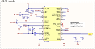

    Here is the TPS25750S

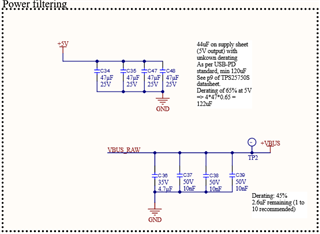

    Here is VBUS and 5V filtering stage:

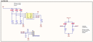

    And here are the EEPROM and the ADCIN configuration
    Note that the PP5V is connected to a 5V rail capable of providing up to 4A.

  • Marc,
    With this schematic, you will need to go to the advanced tab of the GUI and make sure that all of the GPIO are disabled because they are connected directly to ground.
    I am reviewing this with our systems engineer, but I also suggest that your ground VSYS as an experiment because if it is floating and the voltage goes too high, then it can trigger some protection logic that may disable the path.
  • Hello Chuck,
    Thanks for pointing out the GPIO configuration. I've configured them as disabled and it works now.
