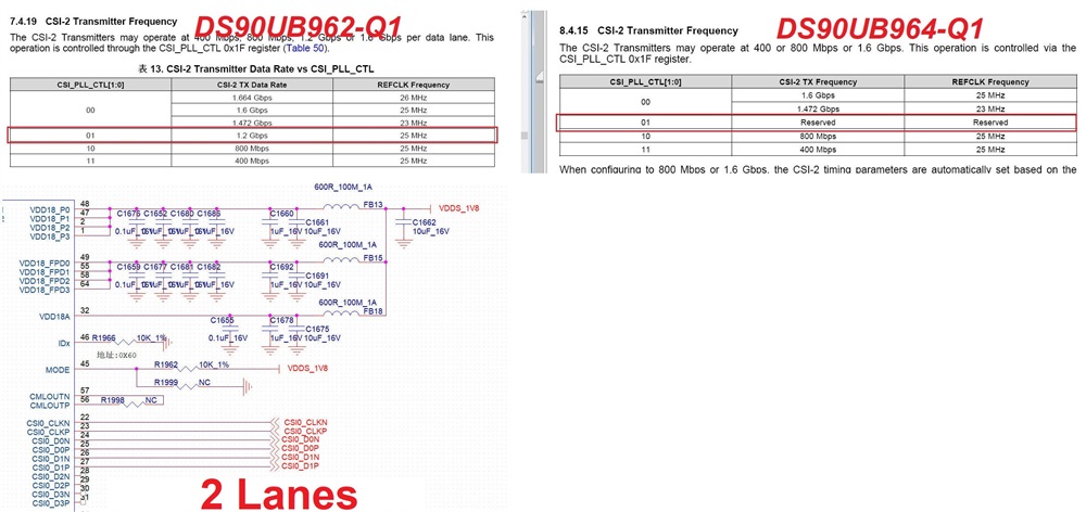

HI:
There is a project in our company that used ds90ub962 for mass production (only two lanes were used), but now it is ds90ub964 due to shortage. Since the software is set to 1.2g, if it is changed to 964, we will set it to "01". What is the speed of reserved in 964? Is it the same as 962? Can the software be replaced directly without modification?
