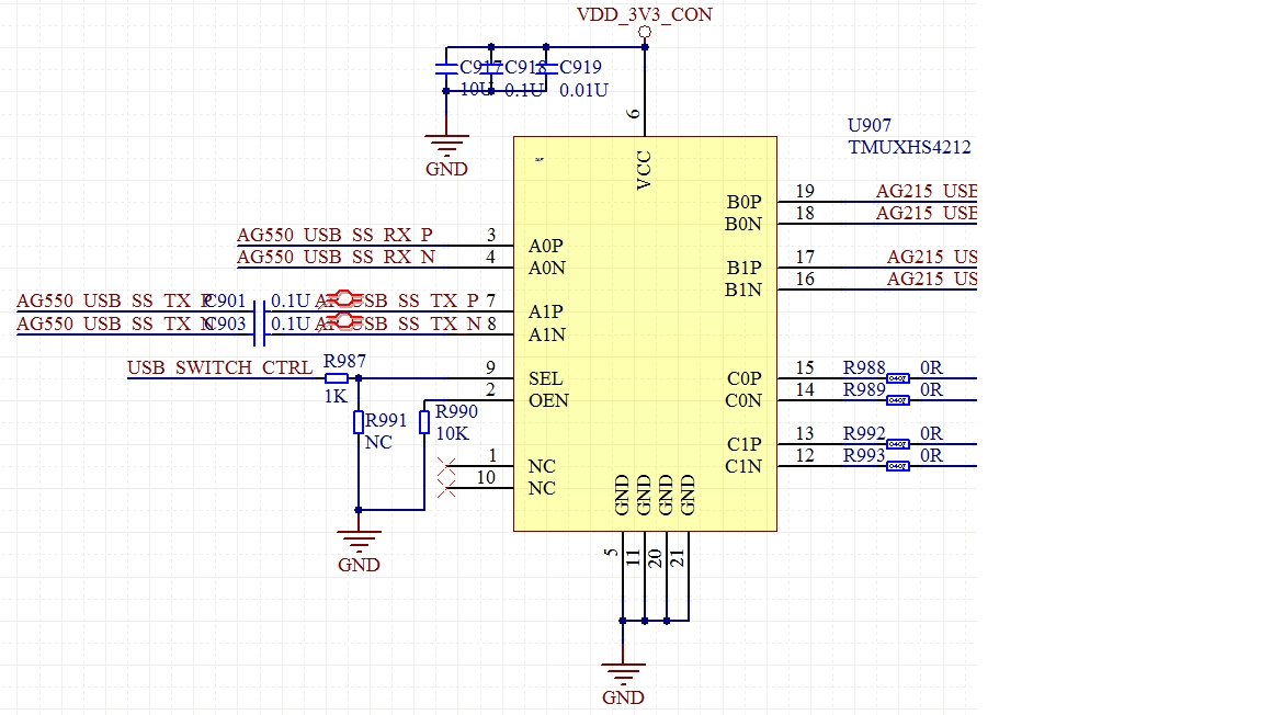

TMUXHS4212: tmuxhs4212irksr -sel pin ?
Part Number: TMUXHS4212
When customers use the chip tmuxhs4212irksr, they encounter the following problems:
When sel pin = L, port a to port B
When sel pin = h, port a to port c
However, when I cut the SEL pin from h to L, it doesn't work. It's still port a to port C.
Here is my schematic diagram. How can I solve this problem?
