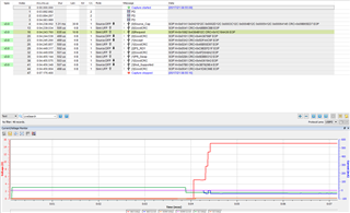

    This is the PD data when the USB-C power supply I am using is connected (note I have change the voltage contract to negotiate 15V instead of 9V):
    The only I2C data I get is when only the I2C1 jumpers are shorted. Here is the data on POR (you should be able to see the data values hopefully):
    Here is some I2C data when a sink is attached (the sink is a ZY12PDN connected to a 10 ohms resistor) - so it can send data on a successful negotiation.
    Here is the CC data upon this sink device being attached:
    and here is the data when the USB-C supply is detached, telling the Bq25703 to return to OTG mode:
