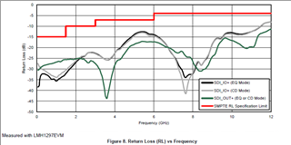

We would like to simulate the return loss of the SDI port.
Please provide us with the following touchstone files and documentation of your measurement environment.
-SDI_IO+ (EQ Mode)
-SDI_IO+ (CD Mode)
-SDI_OUT+ (CD Mode)

Hi nasser,
I have a question about the LMH1297 IBIS-AMI model.
How should I connect the input port to reproduce the input port?
I am trying to connect the FR4 schematic, but it does not work.
-What is the S-para for In0.s4p?
-Analysis cannot be done because of rx_io3.s4p.
(ADS2021 Update1)
Sincerely

Hi nasser,
Thanks for the reply.
We are trying to reproduce "SDI_IO+ (EQ Mode)" as shown in the table in the datasheet.
We do not get good analysis results using the rx_io3.s4p file.
Using the rx_io.s2p file comes close, but is still not very accurate.
・What part of the device is the S-parameter in IO.s4p?
・IO.s4p is an S-parameter of what part of the device? - rx_io.s2p is an S-parameter of what part of the device?
・Is there something wrong with the way the snp file is connected?
Sincerely
