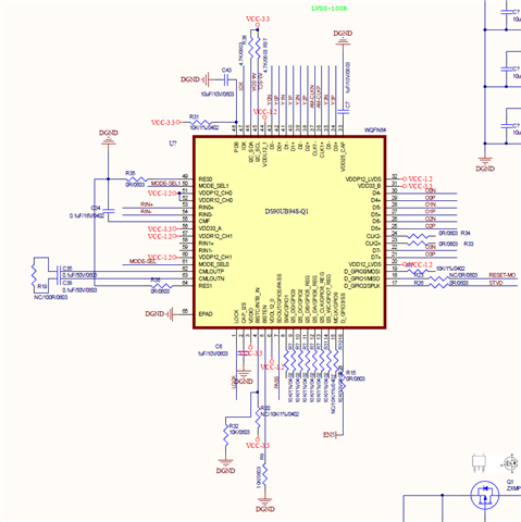

Hi Team,
There is a good news that we DIN DS90UB948-Q1!
Please check the SCH ,THX
  • Hi Kygo,
    Thanks for reaching out.
    Yes, we would be happy to review the schematic. Could you share the full schematic that shows all the component connected to the UB948 device (e.g. power filters, RIN coupling caps ...)?
    Solomon

  • Hi Kygo,
    Attached is the provided schematic with review comments added to it.
    BD2390TA2-L_with_review_comments_20210520.pdf
    Solomon

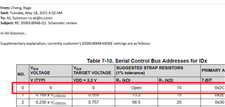

    More question,
    1. Could you explain the difference between OLDI and SWAP? Customer  not sure which setting to choose.
    2. Could you explain the difference between STP and Coax? Customer  not sure which setting to choose.
    3. Please explain the difference between "Repeater setting 0" and "Repeater setting 1"?
    Supplementary explanation, currently customer's DS90UB948 MODE settings are as follows:

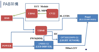

  • Hi Ali Solomon ,
    More question,
    Currently CV22 is connect to UB948, Block diagram as Figure 1 :
    Attachment is customer's panel spec
    1.Please help confirm that the architecture is executable? (as Figure 1)
         (1) CV22 will send 4L-MIPI to UB941
         (2) Then UB948 will turn 4L-MIPI into 8L-LVDS
         (3) And then UB948 will send 8L-LVDS to Panel
    2. Is it possible to convert 4L-MIPI into 8L-LVDS according to the Block diagram(as Figure 1)? Currently Panel  only accept 8L-LVDS !
    3. If 4L-MIPI  can be converted to 8L-LVDS , will  Image resolution become worse?

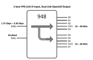

    4. If UB948 can send 8L-LVDS , Can UB948 output  the sort of Figure 2 ?

  • Hi Kygo,
    Re: "1. Could you explain the difference between OLDI and SWAP? Customer  not sure which setting to choose."
    It’s just regarding data mapping differences. In the dual SWAP mode, the two series OLDI output are swapped as shown below:
    Re: "2. Could you explain the difference between STP and Coax? Customer  not sure which setting to choose."
    This is regarding what cable type you are using for the FPD link connection: Shielded Twisted Pair (STP) vs Coaxial cable (Coax).
    Re: "3. Please explain the difference between "Repeater setting 0" and "Repeater setting 1"?"
    This is regarding using the deserializer a repeater, which provides a mechanism to extend transmission over multiple links to multiple display devices. Please refer to the datasheet, section 7.3.14 Repeater, for more details.
    Re: "1.Please help confirm that the architecture is executable? "
    Yes, UB941 should be able to link with UB948 as stated in the datasheet.
    Re: "2. Is it possible to convert 4L-MIPI into 8L-LVDS according to the Block diagram(as Figure 1)? Currently Panel  only accept 8L-LVDS !"
    Yes, assuming that PCLK is within the allowed range, you can select dual OLDI output to achieve that as shown below:
    When in a dual-link configuration, LVDS channels D0 to D3 carry ODD pixel data, and LVDS channels D4 to D7 carry EVEN pixel data. In this configuration the PCLK rate embedded within the 1-lane FPD-Link III frame can range from 50 MHz to 96 and CLK1 and CLK2 will operate at half the rate as PCLK. Please refer to the datasheet, section 7.4.1.2, for more details.
    Re: "3. If 4L-MIPI  can be converted to 8L-LVDS , will  Image resolution become worse?"
    No, assuming that PCLK is within the allowed range, there should be no resolution issues. As explained above, LVDS channels D0 to D3 carry ODD pixel data, and LVDS channels D4 to D7 carry EVEN pixel data and CLK1 and CLK2 will operate at half the rate as PCLK.
    Re: "4. If UB948 can send 8L-LVDS , Can UB948 output  the sort of Figure 2 ?"
    Yes, as explained above, this can be achieved by dual link OpenLDI output configuration. However, one thing I noticed from Figure 2 is that it looks like the display is expecting the data in SPWG bit mapping (MAPSEL = H). On the other hand, in the provided schematic, MODE_SEL0 was strapped for MAPSEL = L. So, there would be a mapping scheme conflict. So, you may need to fix the MODE_SEL0 strapping to select MAP_SEL = H, which changes the position of the MSBs and LSBs. Please refer to the datasheet, section 7.4.2 and 7.4.3, for more details.
