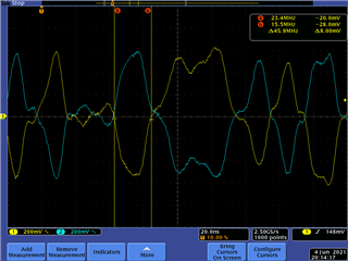

  • Hello Vikram,
    As I am using a pretty old oscilloscope (Tektronix MSO 4032 with 350MHz), I am not able to provide a proper eye-diagram.
    I manged to capture the differential Signal on RX (In the schematics at the resistors R1 and R2) as you can see in the following Image:
    In addition I captured some kind of "pseudo-eye-diagram" using a capture with a waveform-persist-time of 1 second (captured as well at the Resistors R1&R2):
    I'm afraid I'm not able to get any better measurement with my available scope and I hope it does help in any way to solve the persisting problems.
    Kind regards,
    Julian

  • Hello Julian,
    We reviewed the SNR register log that you shared. Looks like signal quality is all good through out but suddenly you get a link-drop. With present available data it is a little difficult to hypothesis the possible root-cause. Team is looking into the possible scenarios, but do you know :
    1. If link-drop happens with some specific system level event?
    2. Does link-drop happens even if you dont transfer any data?
    3. Does link-drop frequency increases/decreases with different IPG?
    Vikram

  • Hello Julian,
    Which signal is this:
    Is this a switching signal?
    Rbias is a sensitive node and disturbance on this can introduce the noise in the receive and transmit path of the PHY. Can we try putting a small cap across the resistor (~10pF but not more than 40pF)?
    Also we can try making led_1 less dynamic and hence less noise dumped to ground  by programming 0x0460[11:8] = x0001 or 0x101 (and not your present configuration of tx/rx activity)
    Vikram
  • Hello Vikram,
    your tagged signal is our "global reset" that resets the µC as well as the PHY. It is controlled manually by a switch.
    To RBIAS:
    I'll request putting a capacitor in parallel to the resistor at rbias and will give a response as soon as I tested its behaviour.
    As rbias is as sensitive as you mentioned, do you see any problem with our placement of the resistor at rbias through a via, or shouldn't that have any influence?
