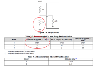

DP83TC812S-Q1: DP83TC812S-Q1 Bootstrap question
Part Number: DP83TC812S-Q1
Hi TI team,
   I have two questions about Bootstrap:
     1. There is an RL resistor in the picture, but the mode description does not specify RL. What is the value?
     2. Can we not configure the bootstap? Increasing the resistance will affect the EMC and Layout;
Looking forware to reply, thanks.
