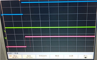

Jabil: The unit failed at start up shows no display information via the boards(see pic below), checking with related cable and connector are OK, and re-plug the cable could show the display windows. But then reboot the power, the failure shows again, it's not related with cable contacting.
we replaced the material SN75DP130, then the failure could be solved with new component, and if we place the defect material on other board, show the same fail again.

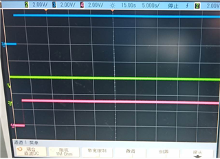

I see the HPD_SNK goes high before the 3.3V, is there a way you can change such that the HPD_SNK goes high after 3.3V is stabilized?
Please also make sure the 3.3V and RSTn follow the requirement in section 11.1 SN75DP130 Power Sequencing.
