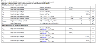

More question :
1. The following table, if Vio input 4V, can it be said to AWR1642 / 1843/6843 VIOIN 3.3V CANFD TX / RX 3.3V?
2. 1642/1843/6843 Power supply VIOIN 3.3V
Hi Kygo,
I'm not sure I understand your questions here. If you're asking if TCAN1044 is compatible with AWR1642, the answer is yes. TCAN1044 can operate at logic level voltages including 1.8V, 3.3V, and 5V. The Vio supply for the transceiver should be at the same voltage as the VIOIN for the controller.
