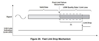

if we set enhanced mode, DP83869HM allow Fast link drop so we can reduce T1 window?
> GEN_CFG2 Register (Address = 0x14) bit[9] = 0, bit[8] = 1
if we don't set enhanced mode, Fast link drop doesn't work so we have to wait T1 window?

    Also enhanced mode feature is only effective when PHY is trying to "establish" link. FLD feature is only effective when PHY is deciding on when to declare that link is dropped. For FLD to become active a good link has to get established first.
