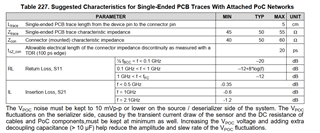

Does it mean that the suggested characteristics in 954 datasheet (table 227) is for bare PCB?
Andy
Hello Andy,
The table in the datasheet is for the channel from the pin of the 954 device through the connector going out of the board and does not need to take into account the 954 device itself

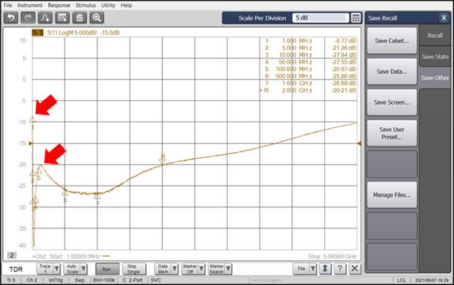

Hello Casey,
This is my S11 graph under the measurement method mentioned above.
I am worried about the data at 1 Mhz and 1XX Mhz. Do these two points matter?
May I have the S11 graph of 954 EVM as a reference?
Andy
Hello Andy,
The return loss specification is from 1/2fBCC (25MHz) to 2.1GHz so the 1MHz value is no issue. Based on this measurement result, the S11 is well within spec.
