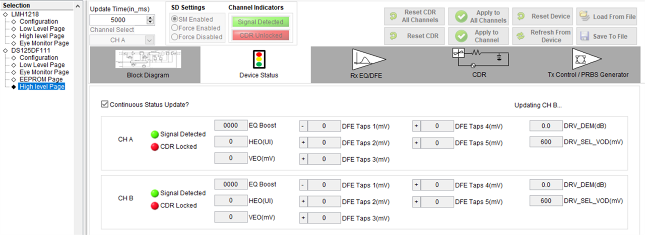

We have some problem when using GUI for DS125DF111.
  1. We were trying to change the config setting under SMBus slave mode with SigCon Architect, however the channel indicator presents red light error as shown below, could you advise how do we lock CDR option ?

  • Hi Cindy,
    What is the input signal data rate and pattern to the retimer channel in question?
    Channel register 0x02 is a status register and not a control register. Other channel registers implement the control functions.
    • PPM check -> channel register 0x2F[2]
    • Single bit transition check -> channel register 0x0C[3]
    Rodrigo
  • Hi Rodrigo,
    The input data rate is 10 Gbps. And pattern is SFI interface.
    Besides, customer is also wondering is there any other people using DS125DF111 implemented in Intel platform or Intel Denverton CPU series design before ? Or do you have suggested re-timer which can support native SFI interface from Intel CPU (Denverton series) ?

  • Hi Rodrigo,
    Here's the register dump.
    config_register.cfg
    The latest situation is customer locked CDR successfully in CHA but CHB CDR still can not be locked...
    They found that CHA CDR can be locked while choosing Ethernet option. However CHB CDR doesn’t work so they wonder is there any different for the VCO frequency between Group 0 and Group1 ?
