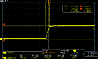

We recommend that you follow the datasheet spec for VDD1.8V rise time of 0.2ms(min)@10/90% and VDD1.1V rise time of 0.05ms(min)@10/90%. A fast rise time can turn on the devices internal ESD protection and damage the device or cause the device not function properly.
