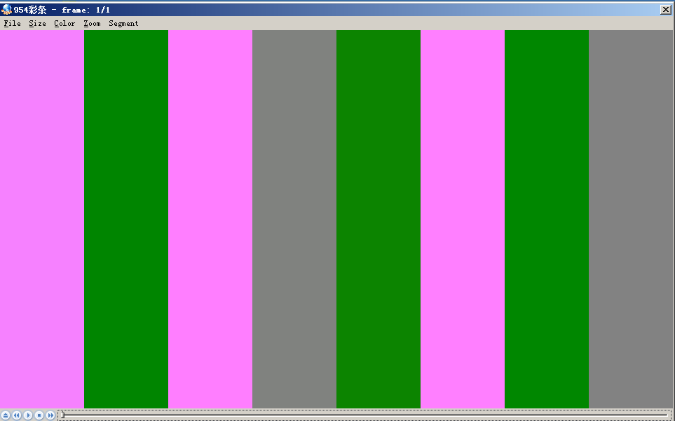

Hi team,
customer use 935+954, found the image picture color is wrong and covered green, but the video is normal. so they use 954 pattern, set output is YUV422 8bit, capture the picture found the color is wrong
see the below.
for the 954 pattern reg setting as below, the resolution is 1920*1080@60fps, YUV422 8bit,
Indirect Register Offset (Register 0xB1)   Description Calculated Value (hex) Register 0xB2
0x02 PGEN_CFG Block size, Number of color bars 0x32
0x03 PGEN_CSI_DI VC-ID and Data Type 0x1E
0x04 PGEN_LINE_SIZE1  Line Size MSB 0x0F
0x05 PGEN_LINE_SIZE0  Line Size LSB 0x00
0x06 PGEN_BAR_SIZE1 Color Bar Size MSB 0x01
0x07 PGEN_BAR_SIZE0 Color Bar Size LSB 0xE0
0x08 PGEN_ACT_LPF1 Active Lines per Frame MSB 0x04
0x09 PGEN_ACT_LPF0 Active Lines per Frame LSB 0x38
0x0a PGEN_TOT_LPF1 Total Lines per Frame MSB 0x04
0x0b PGEN_TOT_LPF0 Total Lines per Frame LSB 0x65
0x0c PGEN_LINE_PD1 Line Period MSB (x10ns) 0x05
0x0d PGEN_LINE_PD0 Line Period LSB (x10ns) 0xC9
0x0e PGEN_VBP Vertical Back Porch 0x24
0x0f PGEN_VFP  Vertical Front Porch 0x04
could you help give some comments why the pattern color is wrong? thank you.
